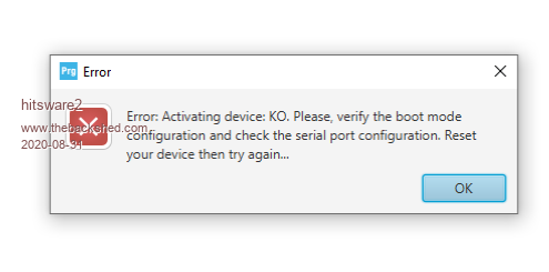

Now has no video out ....
pi@raspberrypi:~ $ sudo dfu-util -d,483:df11 --alt 0 -s 0x08000000:leave --download /home/pi/Desktop/CMM2V5.05.05.bin
dfu-util 0.9
Copyright 2005-2009 Weston Schmidt, Harald Welte and OpenMoko Inc.
Copyright 2010-2016 Tormod Volden and Stefan Schmidt
This program is Free Software and has ABSOLUTELY NO WARRANTY
Please report bugs to http://sourceforge.net/p/dfu-util/tickets/
dfu-util: Invalid DFU suffix signature
dfu-util: A valid DFU suffix will be required in a future dfu-util release!!!
Opening DFU capable USB device...
ID 0483:df11
Run-time device DFU version 011a
Claiming USB DFU Interface...
Setting Alternate Setting #0 ...
Determining device status: state = dfuIDLE, status = 0
dfuIDLE, continuing
DFU mode device DFU version 011a
Device returned transfer size 1024
DfuSe interface name: "Internal Flash   "
Downloading to address = 0x08000000, size = 730272
Download [                         ]   0%            0 bytesdfu-util: Error during special command "ERASE_PAGE" get_status
pi@raspberrypi:~ $
Thought maybe I could revive it with Windows , but :
Edited 2020-08-31 11:23 by hitsware2
my site
Posts: 4381
Posted: 06:43am 31 Aug 2020
I think you have 2 separate problems:
1. the dfu-util one that's hit other ST devices, as shown by web searches
2. something wrong on Windows
Judging by the SOLVED responses to #1 the board is OK (and may be partially erased) but ST have changed timeouts inside various of their CPU bootloaders and a patch to dfu-util fixes it.
I don't have an RPi setup connected to a CMM2 to do any testing but the SOLVED responses will likely work if you apply one or other of the patches.
For #2 (Windows), hopefully a Windows user will post ideas.

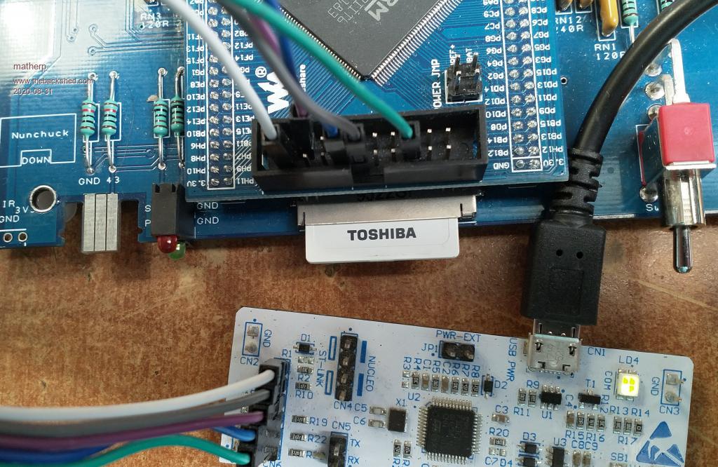

If you or anyone you know has access to any of the ST Nucleo boards you can cross link the ST-LINK header to the Waveshare board and use ST-LInk to re-program
