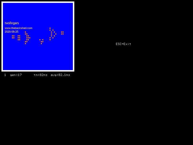

Six years ago I wrote "The Game of Life" for Maximites.
This is the upgraded version of John Conway's GOL for the CMM2. Improvements: graphics, speed and menu for the demos. An editor is planned.
It is fast:
To complete a small world (1000 cells) it needs ~50ms.

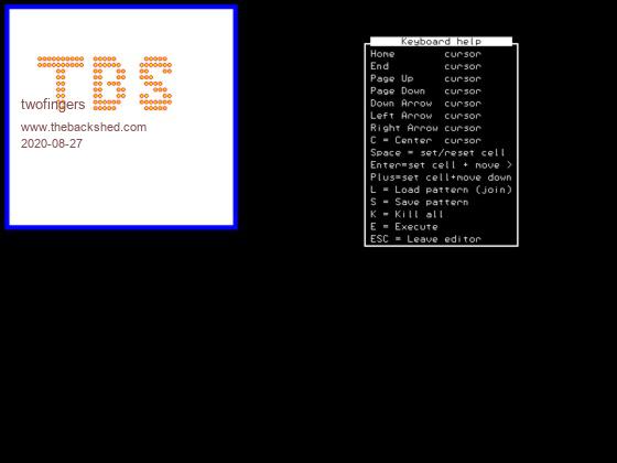

This ist the new version with an included editor. I think it's cool.
Life 202.zip
Included are some ".gol" files please rename to "LIFE.GOL"

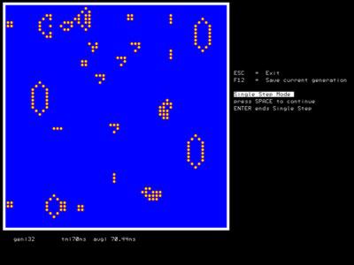

EDIT 27.09.2020:
The latest version has nine slots for storing GOL files, a single step mode, additional GOL files, an auto save mode, improved speed and more.
I included epsilons very useful MAR archive program (v0.3). Many thanks for that!

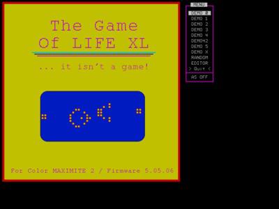

This is the new XL version. It is working with MMBasic >=V5.05.04 but especially for MMBasic V5.05.06 and later. With MMBasic V5.05.06 it is now very fast (8 times than the older version). I had to include a brake.
Livex 35.zip
Enjoy!
