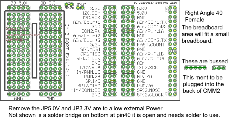

If this is wanted I'll get boards made and get the RA 40 pin female.

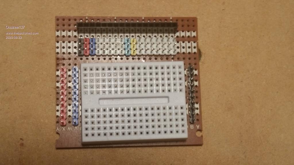

 It is based off a prototype I made for a friend just starting out with
 the MM170BP. I have ordered pcb's for the MM170 version for a group of
 kids.
 Well here it is
 and the prototype of the MM170BP version.

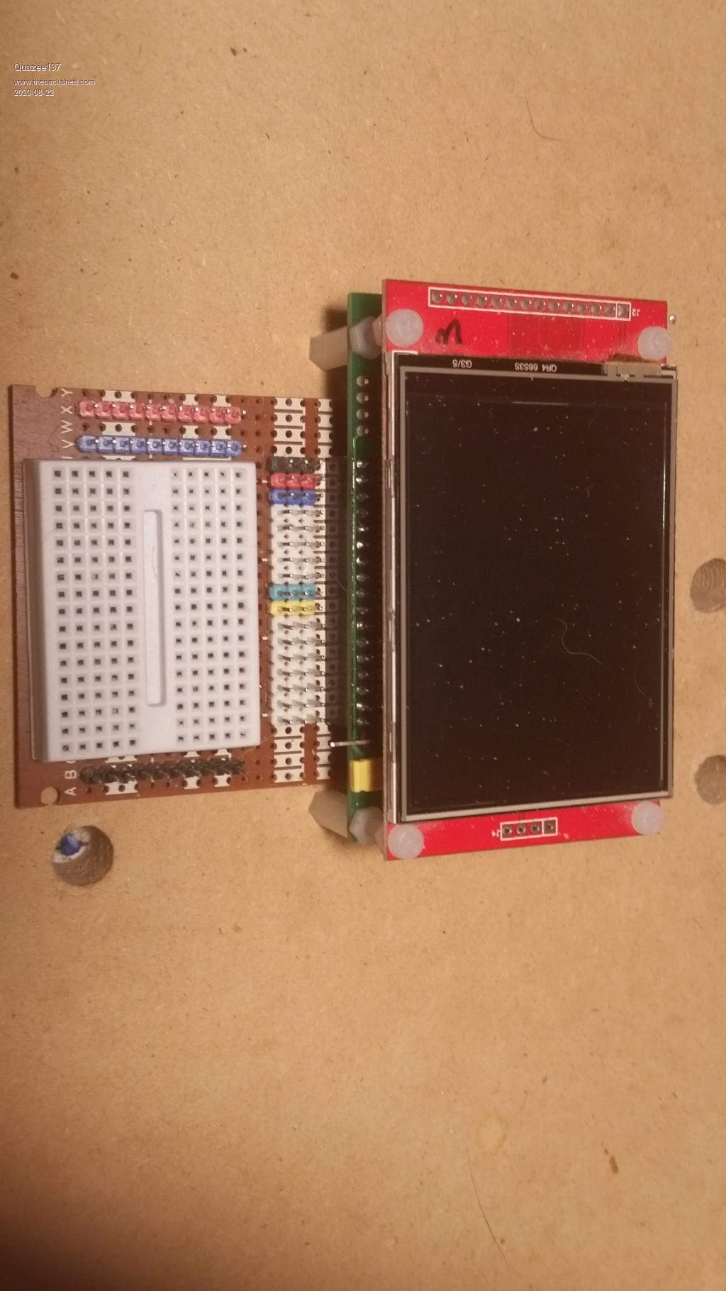

in use.
The 5.0V is red, 3.3V is blue, GND is black I2C Data is green, I2C Clock is yellow.
