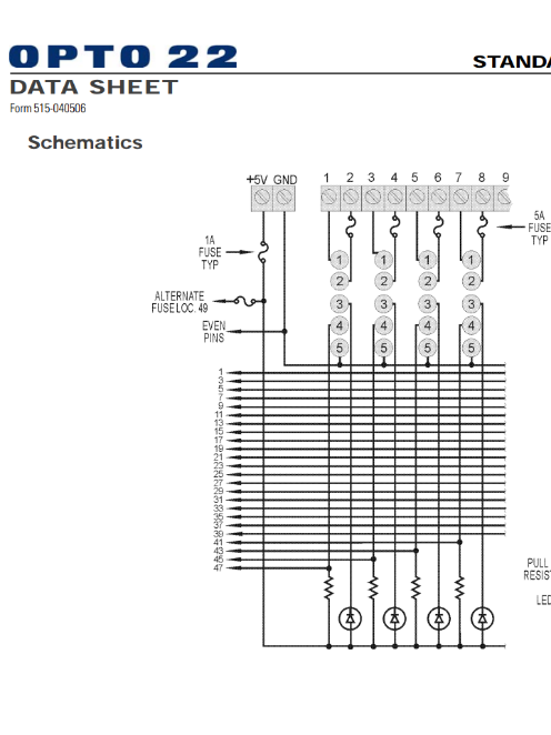

I have an Opto-22 type, solid-state relay-rack.
The rack is fed with 5v and to switch on the relay, the -ve needs to sink.
Does this mean that I can use any output if I use the OC option or is this still a 5v tolerant pin-only option?

Yeah, gonna check the schematic but IIRC, the 5v runs through a led current-limit (opto coupler) and so the MCU just needs to bring that to ground.

Ah, they're not current limiters, they are pull—ups.
