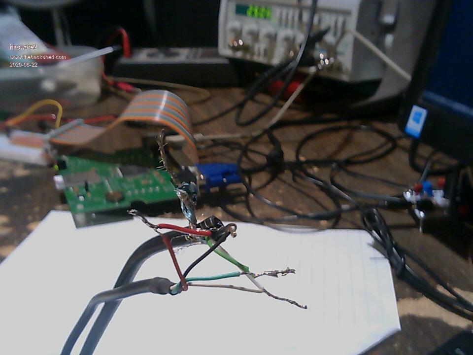

And I saw your picture at https://www.thebackshed.com/forum/ViewTopic.php?TID=12513&PID=152103#152103
It doesn't look like you've got the USB micro-B option either.
hitsware2
Joined: 03/08/2019
Posts: 738
Posted: 03:58am 21 Aug 2020

Posts: 6254
Posted: 06:10am 21 Aug 2020
Since CMM2 is new, comming month SW updates may be coming, so prepare for a decent solution. Very logical is:
For an A-A cable, take 2 out of the Kazillion cables and cut the non-A part off.
On both A pieces solder wire to wire. Typically the wires are color coded. Solder same color together.
For Aussies and Brits:
Typically the wires are colour coded. Solder same colour together.
Or - you order from Ali or Ebay...

Yeah, unless there's something wrong with your homemade cable I would think it should work like a bought one.

I tried both . I ' ll have the proper wires in a couple of days ,
and start over .

>>UPDATE FIRMWARE
Then unplug keyboard and plug into RPi ....
My home brew wire evidently didn't work ...
Maybe Tx and Rx need to be crossed as with
some serial connections ?
