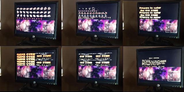

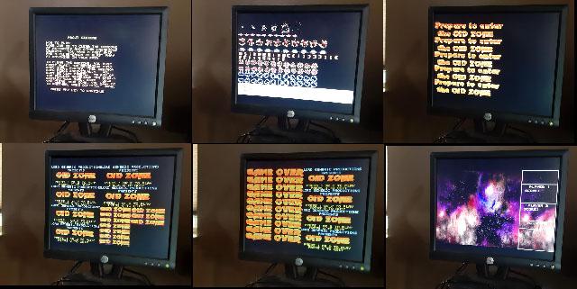

I have found a glitch in page copy in mode 3,8 when the frame buffer is activated and pagebuffer write is set  Page copy x to 0 copies the top half of the page you want and the bottom half of page 7 in this case.  If page write is set to any normal page (like page write 3) it works fine.
before activating and backing up a 333x292 frame buffer. Page copy 2 to 0, 3 to 0, etc.
and after.  I did a slide show in the program after the frame buffer was initialized, setup and backed up, but before the animation of everything started.
the pages are correct, but page copy isn't.  All the art is in place and working
