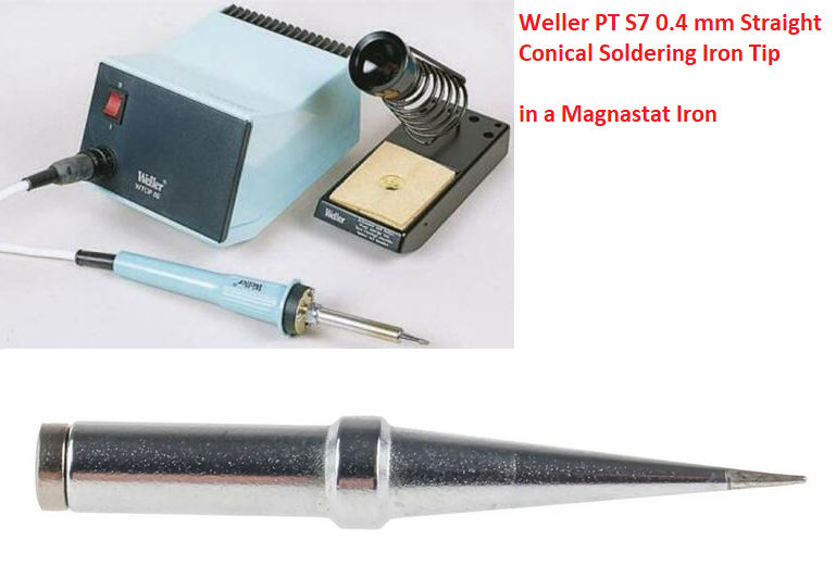

My weapon of choice for building the CMM2 kit:
This Forum Link talks about how I soldered the optional Oscillator mod.
I used a very similar technique for the Audio Socket, and the SD Card Socket.  But with those items, because they have plastic locating lugs that go into holes in the pcb, and in the case of the SD card must be flush with the board, I tacked the items in place with one or two pretinned pads only.  Then used liquid solder from a "flux pen" and carefully solderd the others.  Once I had checked that weverything was flush to the pcb.
Solder wick soaked in liquid flux I found to be good for correcting errors.
Once you have finished, clean the board with flux remover and a toothbrush.  This helps inspection to check for errors.
Hope this helps.

Posts: 6254
Posted: 03:28pm 13 Aug 2020
Weller Magnastat...the best there is. I bought mine 40 years ago....
The S7 tip is for leaded solder.
For leadfree solder use the S8 tip.
But honestly, the magnastats where not designed for leadfree solder. The higher temperatures limit the lifetime. Mine only gets lead....
I am on my last tip. Haven't checked if these are still obtainable.

Posted: 04:41pm 13 Aug 2020
  Volhout said  Weller Magnastat...the best there is. I bought mine 40 years ago....
Bought mine 20 years ago, couldn't afford the 24v power supply so built one using a torroidal transformer and associated components.  Works brilliantly.  I also only use leaded solder.
Tips seem to be still available, but quite expensive (£5+ a pop).
