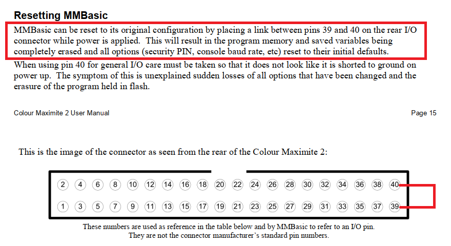

The manual as of 5.05.05b7 states:
I was expecting the CMM2 to be reset to its "original configuration" as stated, and that when I power cycled the machine with pin40 pulled to ground (I used a motherboard jumper across pins 39 & 40) the initial setup program would run, allowing me to select keyboard type, and to set the date and time.

I have also observed that the last program run displayed on the status bar is cleared, and assume that any other options/settings that I may have changed will have been reset too.
I'm not seeing the initial "setup" program ...  is that normal?

Shorting pin 40 to ground will clear all saved options.
It will not re-run the first run setup. That is normal.
The saved options share the backup battery with the RTC which is why removing the battery also resets the options.
