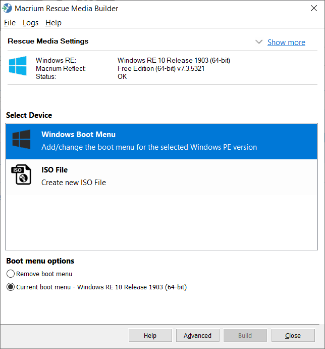

Another option which works is to use the "Boot Menu":
I used to use Acronis (for Win7 and earlier) but Macrium is now my goto imaging software.
