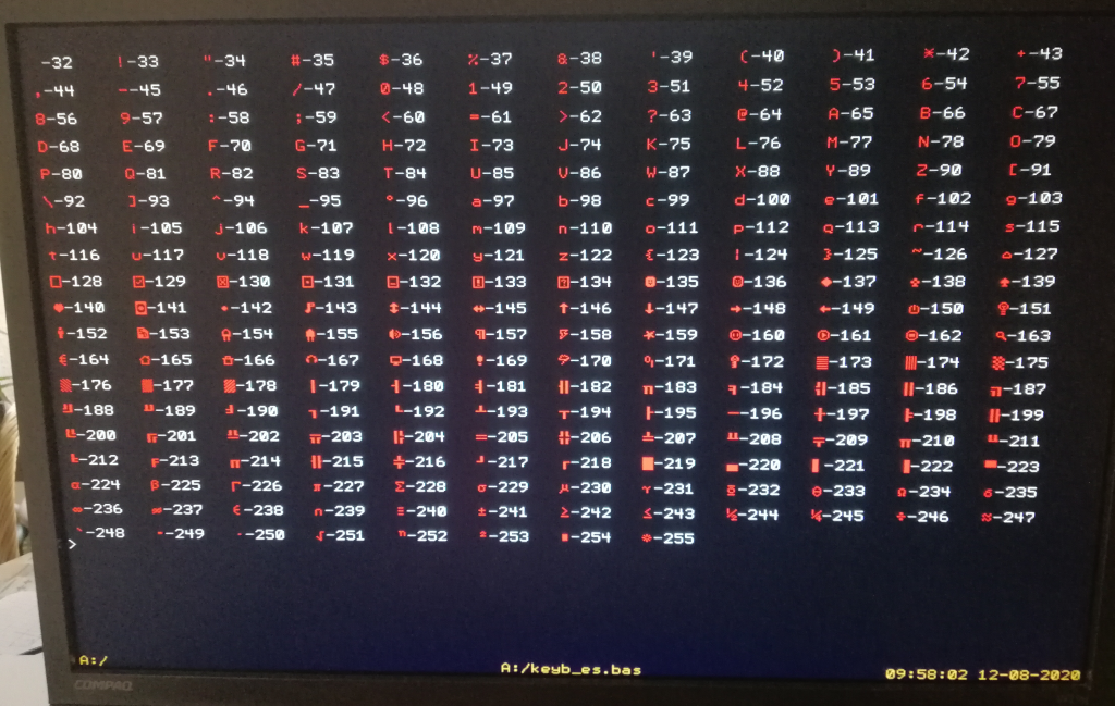

Firmware tested.  ES are the same keys as US layout.... none changed.
Row 1
us               shift
key     cmm2     ES
~   ->   ~   ->  ª  (Normal º, Shift ª, AltGr \)
1   ->   !   ->  !  normal OK
2   ->   "   ->  "  normal OK
3   ->   #   ->  ·  normal OK
4   ->   $   ->  $  normal OK
5   ->   %   ->  %  normal OK
6   ->   ^   ->  &  normal OK
7   ->   &   ->  /  normal OK
8   ->   *   ->  (  normal OK
9   ->   (   ->  )  normal OK
0   ->   )   ->  =
-   ->   _   ->  ?
+ALT GR
us
key     cmm2     ES
~   ->   º   ->  \  (Normal º, Shift ª, AltGr \)
1   ->   1   ->  |
2   ->   2   ->  @
3   ->   3   ->  #
6   ->   6   ->  ¬
Row 2
us               ES       ES      ES
key     cmm2             shift    alt gr
\   ->   \   ->   ç   ->   Ç   -> }
Row 3
us               ES       ES      ES
;   ->   ;   ->   ñ   ->   Ñ   -> none
'   ->   '   ->   <   ->   >   -> none
Row 4
us               ES       ES      ES
,   ->   ,   ->   ,   ->   ;   -> none      normal OK
.   ->   .   ->   .   ->   :   -> none      normal OK
/   ->   /   ->   -   ->   _   -> none
Edited 2020-08-12 08:41 by Hark0

My first program when I receved the CMM2 was:
for n=32 to 255
print chr$(n)
next n

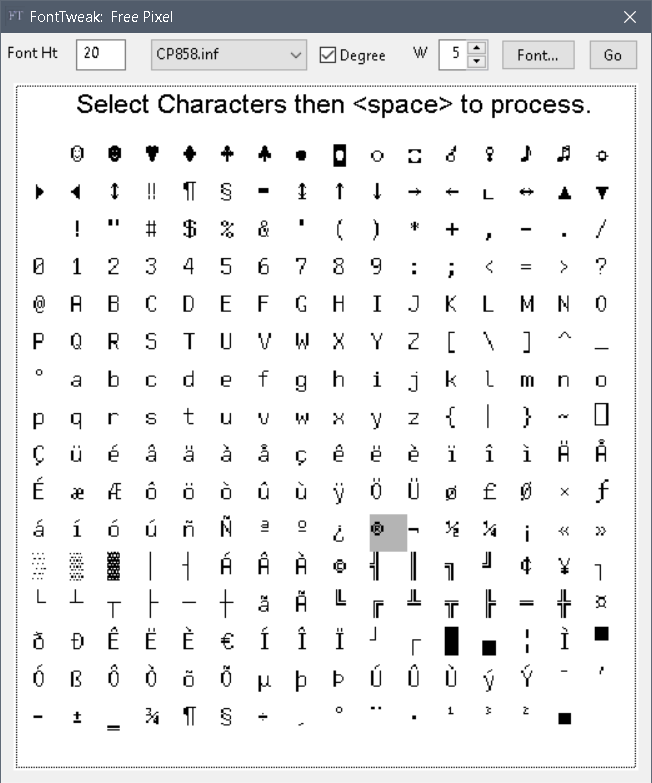

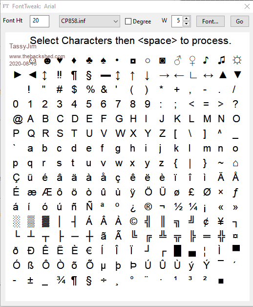

for n=32 to 255
print chr$(n)
next n
Will always print the built-in font which contains ASCII characters for the lower characters and a selection of various characters for the high number characters.
If you want to print international characters, you can define your own font and then print them using chr$(xx)
The CMM2 will not be able to use unicode or uTF8 to print all international characters.

Hello again... reflashed my CMM2 for three times...
Now it seem works (¿?).... and option info shows "OPTION USB KEYBOARD ES". ;-)
This Keys NOT work correctly
Key º in US Layout (left to key 1):
 Normal: none, expected º chr$(96)
 Shift: none, expected ª  none char in CMM2 - ASCII 166
 Alt Gr: \ OK. Correct
Key = in US Layout (right to key -):
 Normal: none, expected ¡ none char in CMM2 - ASCII 173
 Shift: none, expected ¿ none char in CMM2 - ASCII 168
 Alt Gr: none OK. Correct
hmmmm about this key... i think "OK".... don't modify. ;-)
Key [ in US Layout (right to key P):
 Normal: º, expected ` chr$(248)
 Shift: ^, expected ^ OK. Correct
 Alt Gr: [, expected [ OK. Correct
Key ; in US Layout (right to key L):
 Normal: none, expected ñ chr$()
 Shift: none, expected Ñ chr$()
 Alt Gr: none, OK. Correct
 I think about "Ñ" key.... are "OK"... none char in CMM... or maybe.... n and N.
Key ' in US Layout (right to key ;):
 Normal: none, expected ´ none char in CMM2 - ASCII 239
 Shift: none, expected ¨ none char in CMM2 - ASCII 249
 Alt Gr: }, expected { chr$(123)
Hmmm the keys \  and  /  "are exchanged", codes are OK.

Hmm for the keys that not have graphic defined.... hmmm the best "solution" IMHO... are use the same graphic... like  not existent ª... use º
I used the chr$ from the photo...

You know, spanish keyboard layout have some extra keys:
ç, Ç, ñ, Ñ, ¡, ¿, á, é, í, ó, ú, Á, É, Í, Ó, Ú, à, è, ì, ò, ù, À, È, Ì, Ò, Ù, â,ê,î,ô,û,Â,Ê,Î,Ô,Û,ä,ë,ï,ö,ü,Ä,Ë,Ï,Ö,Ü...
How I add these graphic definition... Using Fontweak ?

  Quote  You know, spanish keyboard layout have some extra keys:
Yes.
But you have to do some work.
Before Unicode, Windows/DOS used 'code pages' for the different character sets used around the world.
If you know what code-page matches your language, that is the first step.
Then you have to find the Unicode equivalents for each character. Wikipedia is very useful here.
Once you have the ASCII to Unicode translation list, you can create an INF file file FontTweak.
The last step is finding a TTF font that has the Unicode characters you are interested in. That is easy to do in FontTweak.
One of the code-pages I have translated already might be what you are looking for.
You will still have to use chr$(xx) to print the characters. You 'could' change characters below 128 to print them directly but that would really mess up the whole system so I don't think that it is a good idea.
