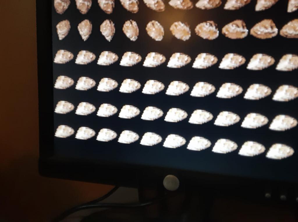

Hey all here's a link to a youtube video I did of an asteroid blit test.

you can set the blit to not copy transparent pixels, but then when they are spinning in place they won't erase the previous copy. I tried it with overlapping oids and they were masked correctly.
I wasn't sure how fast the blitting was until I tried it here. wow  Now I'm certain I can blit with color 0 removed  onto a fresh nebula on another page and blitted to page 0.  I'm working on a test for that, but I ran into a snag with loading pictures

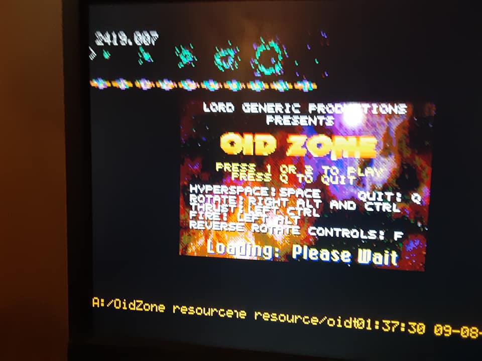

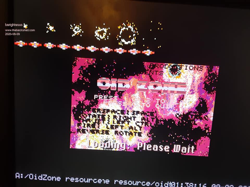

I have bmp and gif files WITH THE PALETTE I'm using, but when they're loaded THE COLORS ARE BEING REMAPPED TO FIT THE DEFAULT PALETTE INSTEAD OF THE PALETTE I JUST SET, so all the colors are wonky.  If I map reset, poof the gif or bmp I load looks right and all the other graphics on the screen have garbled colors. I would expect it should try and remap if it has to to the CURRENT PALETTE! Why can we set a palette if loaded art in the right format won't map to it? The picture are 8 bit specifically set to the palette I'm using. (I rechecked in photoshop and i'm changing the palette according to the photoshop palette file.) scratching my head on it.
S0 I have to go back to the original software I used 20 years ago to process those pictures like I did the sprites.  In the PC game I could just load the image and the palette and everything was fine.

no, it's definitely remapping the picture to the default palette. When I map reset all the colors on the screen change and the image colors pop back to looking exactly like it does if I load it without changing the palette.
Posted: 11:35am 09 Aug 2020
The BMP and GIF decoders know nothing about any colour mapping. They just convert the incoming data to RGB888 and that then is loaded to the screen using the standard RGB888 to RGB332 mapping. To do anything else would be unrealistic: for each pixel search the map table and look for the nearest match? using what criteria?

So I have a workaround for CMM2 not loading my images "correctly."  I searched the web and found the archives of the old euphoria language release I used to create the games originally.  I have to run them in dosbox now.  Then I can go back to the original euphoria programs that created my other data files, and I can make them load the 320x200 images into a euphoria object and then write out just the color index matrix to a data file, that I can read in my cmm2 program and have it look correct.

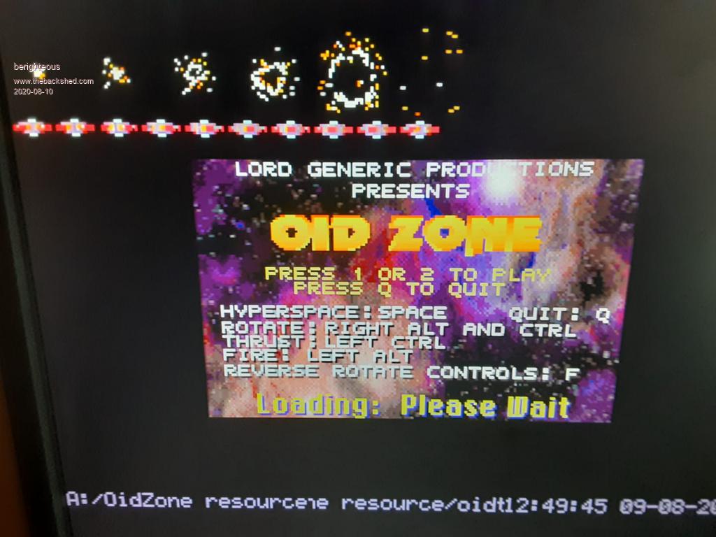

ok I processed the bmp using ancient vga secrets and created a data file of just the pixel color indexes and can load it in.  Tada!
