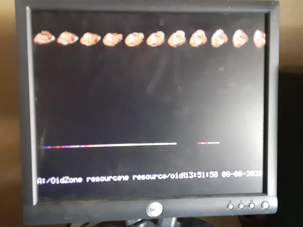

here's what it looks like doing it the hard way.  Here's the code.  The colored line at the bottom is the 8 bit palette.
mode 3,8
'load bmp "bkgr1.bmp"
open "palette.dat" for input as #2
for i = 0 to 255
input #2,r,g,b
map(i)=rgb(r,g,b)
next i
close #2
map set
for i = 0 to 255
pixel i,150,map(i)
next
open "newstuff.dat" for input as #1
for k = 0 to 10
for i = 0 to 26
for j = 0 to 28
input #1,c
pixel 30*k+j,i,map(c)
next j:next i:pause 100 :next k
