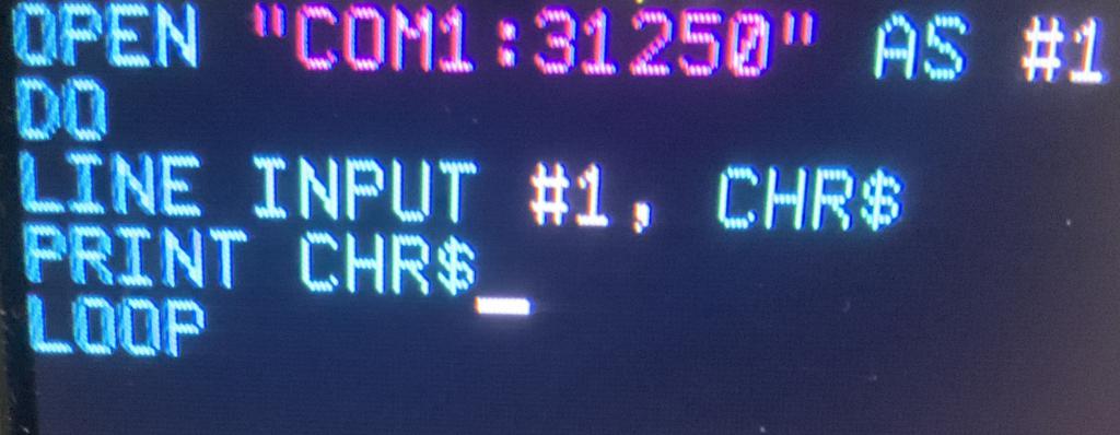

Trying to read a midi signal from com1, the manual doesn’t give much detail on reading com signals so I adapted the basic temperature sensing example, but not getting anything printed to screen when data is sent. I am a total newb at this so probably something I’m overlooking.
I have checked the hardware connections and they are correct and the sending device is sending correctly, so obviously my code is crap

Update - when I send a lot of data I get an error: Line is too long
So it seems like the com 1 is receiving the data but it isn’t printing it to the screen, basically I want it to print each time it receives any data.

Line Input will wait for a carriage return character before returning your input data.  Have a look at the Input$ function.  Also CHR$ is a reserved keyword and shouldn't be used like this.
Try something like this in your do loop:
C$ = Input$(1,#1)
Print C$;

Much thanks @sasquatch I am at least now getting data on the screen, the data is not in the correct format though so I guess now I need to figure out how to convert the raw serial midi input (hex?) to meaningful data, possibly something to do with setting up the com port parameters?

CHR$ is a reserved word. Use a different name for your variable.
Also, what is the physical connection? What are the voltage levels, polarity, etc. The CMM2 (that I think you are using) expects 3.3 volt signals, idle low? High? I'm not sure. What about the midi end?
If the data is coming in as binary, you might want to convert it to something you can see and recognize:
C$ = Input$(1,#1)
Print HEX$(ASC(C$),2) " ";
