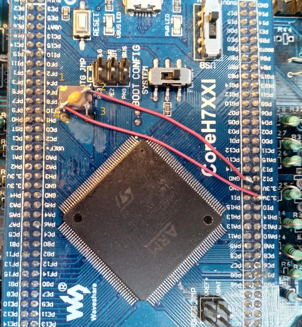

Hi there,
I've soldered together a CMM2 from parts and I'm having an issue with the video output. One display, an old LCD TV, cannot see the VGA signal. Another display, an LCD computer monitor, sees the VGA signal but repeatedly keeps blacking out rendering it unusable. When the image is visible, the video looks great. The firmware also appears to continue running even while the display is blacking out (the machine registers key presses).
There appears to be some dependence on what the firmware is doing - this never happens in the command line mode, and it is especially bad when the cursor is on the third line in the edit mode.
I probed the 5V and 3V3 on an oscilloscope - looks clean and accurate. I've tried different power supplies: PCs, laptops, wall adapters. So far I can't identify any problems visually with the soldering or the components.
Perhaps related: putting my thumb over the crystal pads on the Waveshare board causes the exact same symptom.
Any ideas would be much appreciated. Thanks!

The best fix is to do the Crystal modification.
Replace the 8MHz xal with a 8MHz oscillator module. It is more stable and keeps the vast majority of monitors happy.

I had blacking out issues on my diy board too. Theres a spot under the waveshare board (on the cmm2 pcb) for the xtal ocscillator and 10uf cap, as TassyJim said. I installed these myself the other day (very fiddily) and it worked perfectly.

The Parts I used:
  Womble said
LFSPXO018045
Oscillator, Crystal, 8 MHz, 50 ppm, SMD, 7mm x 5mm, 3.3 V, CFPS-73 Series
https://uk.farnell.com/iqd-frequency-products/lfspxo018045/crystal-oscillator-smd-8mhz/dp/9713468?st=0705%208Mhz%20oscillator
http://www.farnell.com/datasheets/2551800.pdf
Size: L: 3.2mm W: 1.6mm H: 0.55mm
Footprint: SMD 1206
Package formation: SMD tape
100nF: 16V +/- 10%
https://www.ebay.co.uk/itm/1206-SMD-Capacitors-90-Values-Available-10-Pack-UK-SELLER-Same-day-dispatch/264566930175?ssPageName=STRK%3AMEBIDX%3AIT&var=564323940840&_trksid=p2060353.m1438.l2649
eBay item number: 264566930175
Which way around ?
  matherp said  You can just see the pin 1 dot in your picture - top right
Parts should be fine. Be very careful soldering the oscillator that the solder doesn't wick up onto the case.
It will probably work even if you leave the crystal in place on the Waveshare but it does kill the crystal
I left the crystal in place, and can confirm that this was OK for me
  Womble said
  KeepIS said  Retrofitting the xtal module is a pain. Solder paste was no good as once the header sockets are soldered in, there is no room to get a fine tip soldering iron at the right angle, there is no lead length at all on the xtal case. I wasn't game to try my  soldering heat gun even with a tiny nozzle as it would likely melt the plastic 80P header socket.
I agree 100%
When I fitted the crystal oscillator.  Do this first!!! I tinned the pads on the pcb, used solder wick to make sure there was only the smallest amount of solder bulge on the pad, applied some liquid flux, and tacked each of the 4 corners with a hot needle point iron.  This did a neat job for me.  As mentioned previously, be very careful not to create a short with the metal lid on the oscillator.
Pin One on the oscillator is a different shaped pad on the underside of the device.
(I grabbed this from the datasheet)
Then I had a go at the "grain of rice" (capacitor).  The same technique worked, but it is not pretty or flush to the pcb.  The capacitor is not polarised and can go either way around.
A magnifying glass, tweezers to hold compnents in place and a pointy iron got the job done ... even for an amateur hobbyist like me.
Fitting these to the pcb before assembling the waveshare headers would be a good idea if you get the chance.
Good luck with this, hopefully should fix your problem.

I have done both my boards using the dead bug style like in Peters photo.
You don't have to remove the old crystal so it can all be done without removing the Waveshare module.

I will have to give the dead bug fix a shot! The dead bug fix crossed my mind but I was not sure if it was necessary to remove the crystal. This is great news.

I am glad to say that dead-bugging the oscillator as matherp depicted fixed the issue entirely for me. My CMM2 now works at full 800x600 resolution on any display device I try it on. The fix was easy to do. Thank you everyone for your support!
