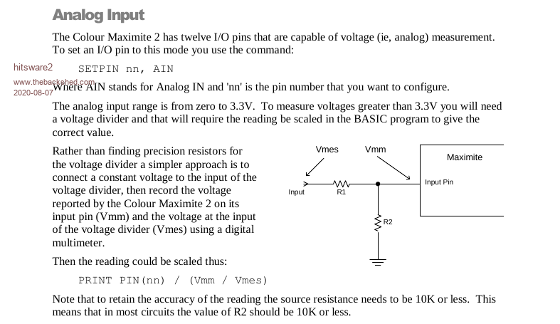

Would do it , but there seems ( from user manual )
much further complications ( and even different commands )

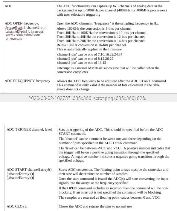

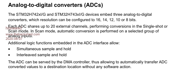

From chip description  :
From programming manual :
From user manual :
Any insight appreciated

That is what the ADC command is perfect for.
It reads the pin in the background and fills an array for you. All in the background and bloody fast if that's what you need.
The bits/resolution depends on the sampling speed you choose.
You can then concentrate on doing the any maths and displaying that's required.

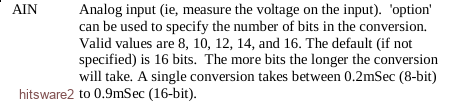

No-one has mentioned the impact of setting the ADC accuracy
Try
setpin 7,ain,16
timer=0
for i=0 to 999
a=pin(7)
next i
b=timer
timer=0
for i=0 to 99
next i
print (b-timer)/1000
then
setpin 7,ain,8
timer=0
for i=0 to 999
a=pin(7)
next i
b=timer
timer=0
for i=0 to 99
next i
Edited 2020-08-07 17:44 by matherp
Posted: 07:56am 07 Aug 2020
I have found something "interesting"
On my Y revision board
  0.702454
  0.070334
On my V revision board
 1.345789
 0.077606
The V chip take twice as long as the Y chip when using 16bit resolution.
hitsware2
Joined: 03/08/2019
Posts: 738
Posted: 11:57pm 07 Aug 2020
  matherp said  No-one has mentioned the impact of setting the ADC accuracy
setpin 7,ain,16
setpin 7,ain,8
The
16
and
8
Are ' bits ' accuracy ?
Corresponding to different sampling rates ?
my site
Posted: 12:33am 08 Aug 2020
setpin 7,ain,16
setpin 7,ain,8
The
16
and
8
I completely forgot that you can set the ADC bit resolution with the SETPIN command.
I should read the manual more often.
The bits are the resolution of the ADC converter.
8 bit give 256 discrete values, 16 bit gives 65536 discrete values.
In most cases, 16 bit is far more than required. 10 bit should suit your simple graph.
The fewer the number of bits, the faster the conversion can go.
hitsware2
Joined: 03/08/2019
Posts: 738
Posted: 12:53am 08 Aug 2020
Speaking of manuals .....
The ' user ' manual doesn't even mention
' AIN ' .... Unless I ' m missing it someways ....
Should be not far after ' ADC ' ?
my site
