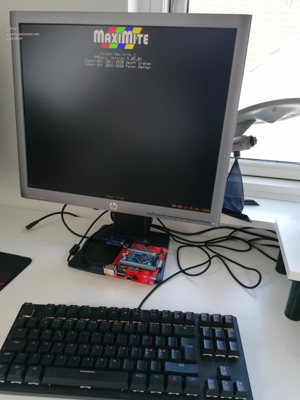

Well, I received all (almost) the final parts - which produced a working CMM2. I just need to get the SD card working.
The image is very sharp and clear (800x600 on a 1280x1024) monitor, even at the non-integer scaling. I use (and am used to) Danish keyboards, which constitutes a problem. I am going to post in the thread regarding "foreign" keyboards.
However, I do have a slight issue with the keyboard input. The CMM2 misses many inputs, which really cuts down on the enjoyment. I tried the OPTION USBKEYBOARD XX command many times, and every single time something was missed. I have to look every time I press a button to make sure that it registers.
Any advice?
