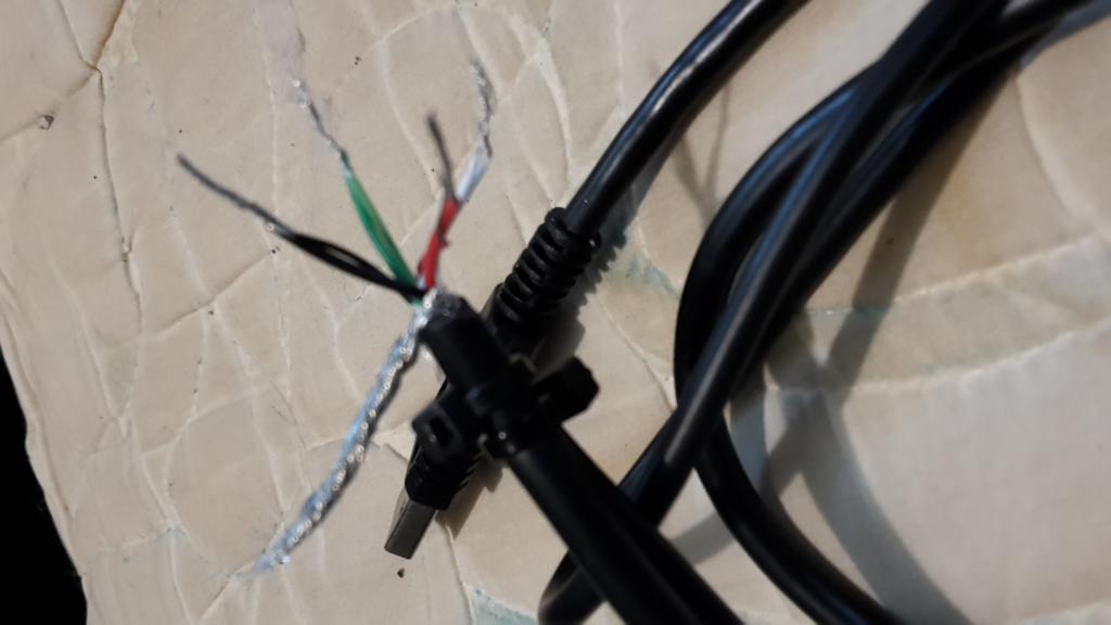

  Womble said
  jpusztai said  The only problem some folks might have is getting their hands on a USB Type A-Type A cable; these are not very common.
I bought this one:
eBay item number: 184324984489 USB 3.0 Type A Male to A Male Data Cable
I have also successfully used one of those double headed USB-A cables that came with Startech USB 2.0 2.5" HDD Caddys
I "made" one from 2 A-B cables (obviously not "finished")
