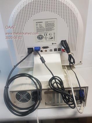

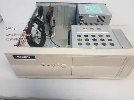

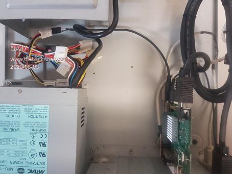

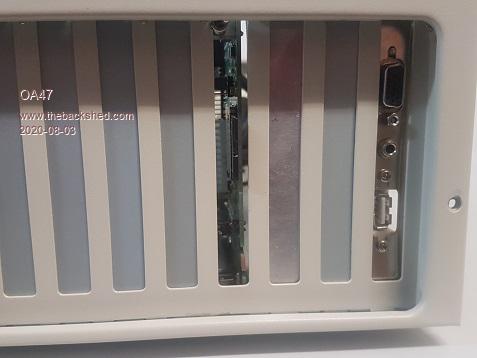

I have a collection of NOS(New Old Stock) AT cases in the shed and decided to house my CMM2 in a baby AT desktop chassis to give it the classic retro feel. I chose the AT format case as it can provide the height needed to house the CMM2 board vertically. I wanted to keep all of the functionality and not modify the current format as much as possible. I was able to get access to the SD card and Nunchuk ports at the rear. I Have the SD led, PWR led and RESET button on the front panel and made a back plate to present the USBhost, Audio and VGA connectors.I have used the original AT power supply as I wanted to utilise the front power switch to also control power to the monitor. The Power/Console USB is connected to the 5V supply.
I found an appropriate beige monitor which had inbuilt amp and speakers as well as a beige USB keyboard to match the theme.

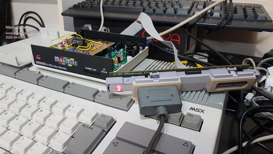

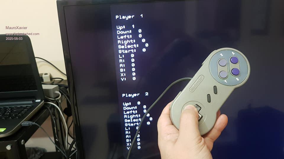

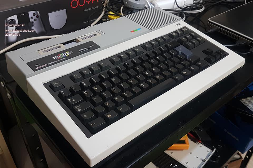

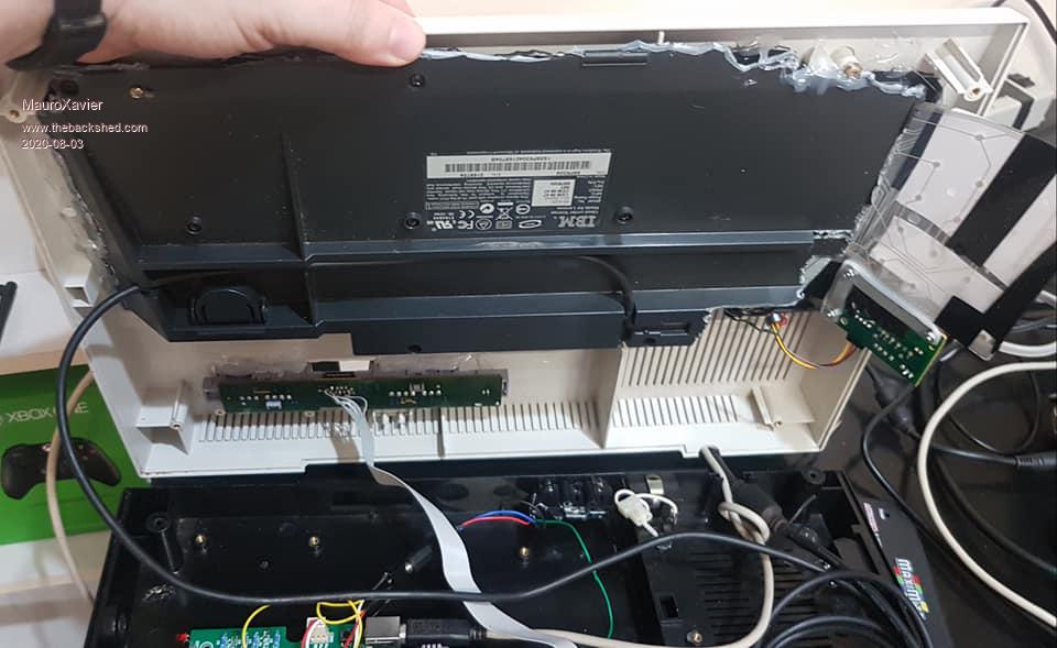

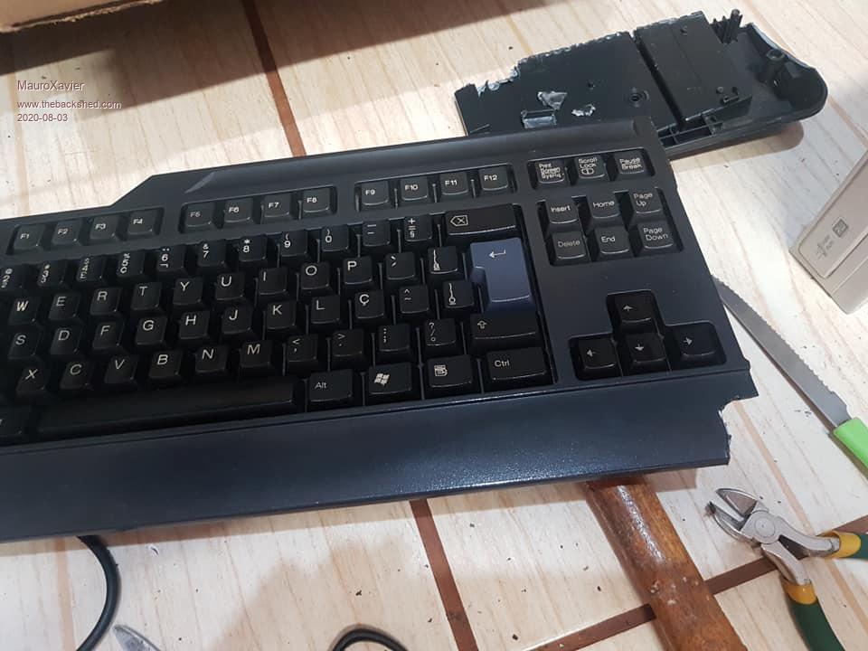

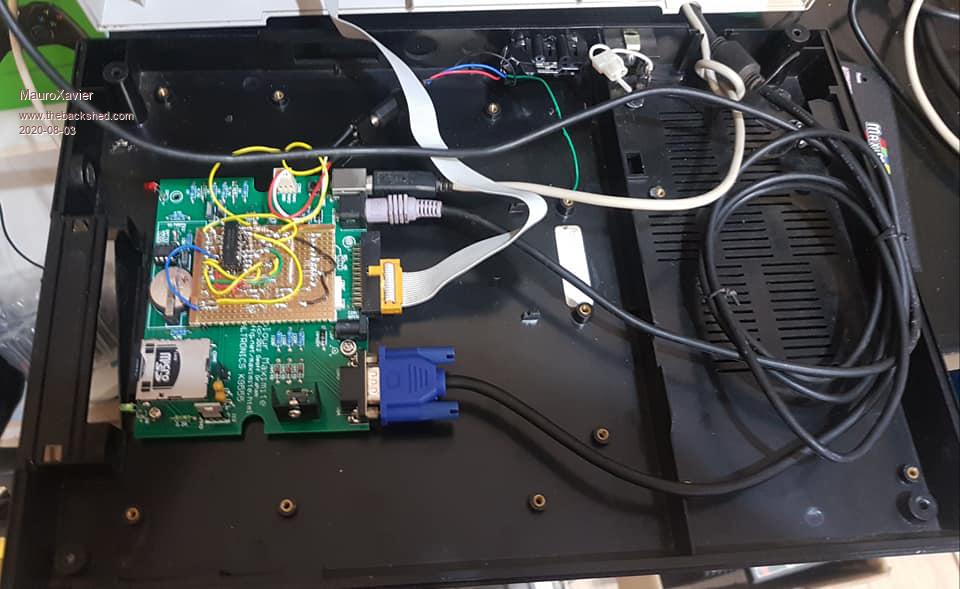

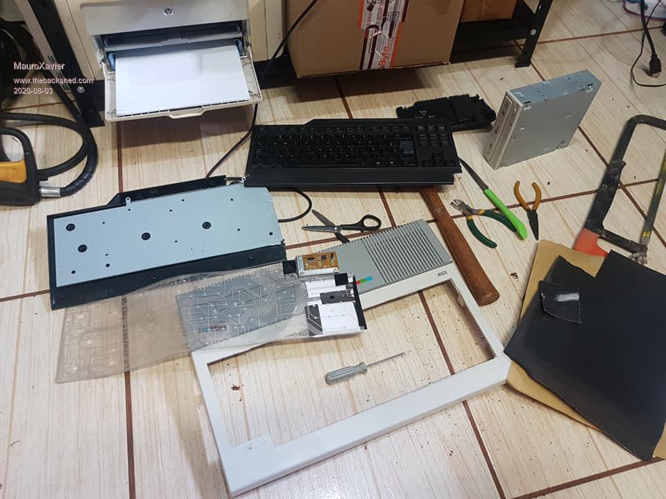

Here are some pictures of what I did with my first CMM about two years ago:
My original CMM have two SNES Control ports and one SN76489 sound chip, but today with our almighty CMM2 none of this is necessary anymore

Hi Mauro,

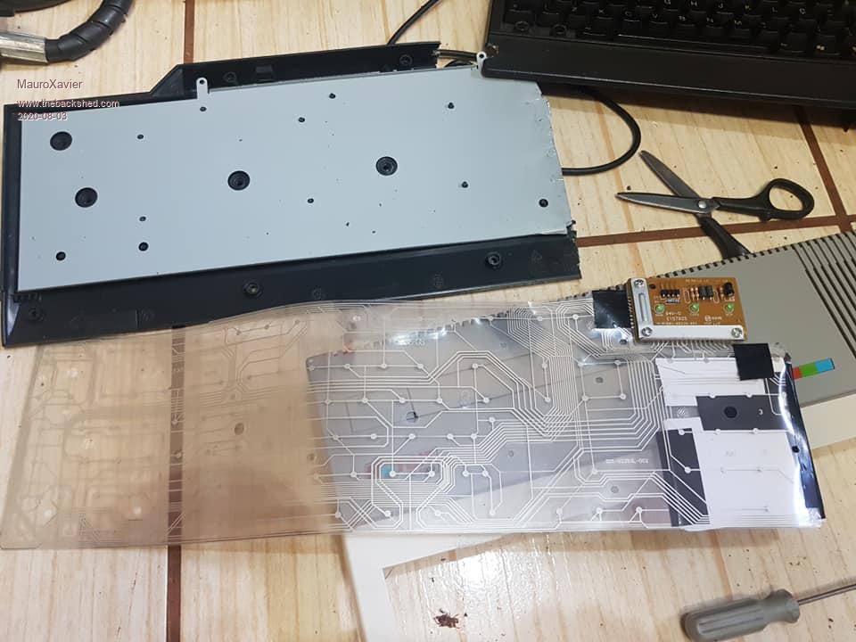

From the outside it looks dandy .... inside is "functional".
Nice you used the old front panel ...
I am surprized to see that the hotglue holds the keyboard in place... After so many hours of programming.

Posts: 6126
Posted: 12:50pm 03 Aug 2020
My CMM1:
And.....In use by my grnddaughter, playing Mauro's Gauntlet
Edited 2020-08-03 23:06 by Volhout

  Volhout said  I am surprized to see that the hotglue holds the keyboard in place... After so many hours of programming.
I used hot glue and screws too.
