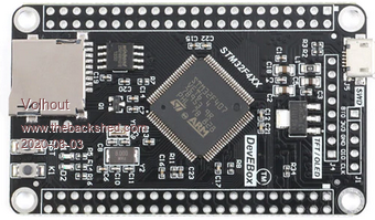

I stumbled upon this one:
Smaller F4 board
There is no LCD interface, the RTC battery must be wired external.
The 44 pin headers have the IO pins arranged identical to the board I am using now, but the power pins are at different location.
I have ordered one, and will test if MMBasic runs on it.
P.S. haven't found schematics yet, so not sure it works...

Posted: 11:11am 06 Aug 2020
I finally found readable schematics (on the micropython github site).
It looks possible to put Peter's code on it.
However.....
The original F4 board has a 16 bit parallel drive LCD. The IO pins (occupying most of port D and port E) will not be accessible with the original F4 software.
So the only benefit for this board is that it is physically smaller.
Differences:
- W25Q16 flash chip select on pin PA15 (versus PB0 on F4)
- BOOT1 fixed to GND (that is fine)
- A LED connected to PA1 (versus 2 LEDs at PA6 and PA7 on F4)
- SPI LCD connection at SPI2 (versus 16 bit paralle LCD on port D and E at F4)
- KEY0 and KEY1 are missing
- no battery holder
- pinout GPIO connectors different (especially GND/Vref/5V/3.3V pins)
Is it worth to pursue..?
At 6 dollar, it is 4 dollar cheaper than the F4 board. If you need to attach an LCD, buy the original one. If you don't, you would need a special Armmite version to get access to the port D and port E pins.
I will report if Peter's code run's on it, once I get the board.

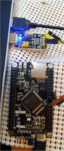

Bad luck
Today I received my smaller STM32F407VET6 board (the DevEbox board).
With a jumper I connected J1 pin 1 and 2 and got the board to boot in DFU mode.
Witch the Cube programmer, I could write the ArmmiteF4.bin file, it programmed, and verified OK.
Then I removed the jumper, and ....nada....nothing.
It did not enumerate on my windows machine (same as my 'defective' Armmite F4 board).
Then I tried the first version Peter made (that one ran on my earlier defective board...it ran..kind of). Nada.
Tried a linux machine, and with 'lsusb' noticed it did not enumerate at all.
So I am out of luck.
It is either defective, similar to the old one.
Or it does not boot Peter's code because it does not have the LCD wiring on this board.
1- I will do an extra check on the schematics, to see if there is some wiring difference that may be critical.
2- I will (when time permits) to see if I can build micropython (there is a custom version for this DevEbox board) and check it that boots.
3- I may try the version with serial port, and see if that one works.
Not sure what to try first...maybe 3-
Worst case, there is $6,00 down the drain....

1 - Extra check on schematics:
By adding a resistor 1.5k between the USB D+ line and 3.3V the board starts USB. This was a difference between the original, and this DevEbox board.
The Windows PC recognizes the board, but the message is "windows does not recognize it". That is exactly the behaviour of the earlier boards. In device manager: Device descriptor request failed".
Meaning: when you are lucky your board works, when not ... no solution, as I spend many evenings to get the old board working. no luck..
Posts: 6254
Posted: 11:27am 17 Aug 2020
After one whole evening of trying to make it work:
- increase Vcap capacitors
- faster reset (add pullup and even vary)
- external 8MHz clock
- switch in 1.5k pullup at B+ after startup, not direct from 3.3V
- trying serial port version of MMBasic...
I fried the board (*). It does not even want to go back into DFU mode.
End of this experiment.....

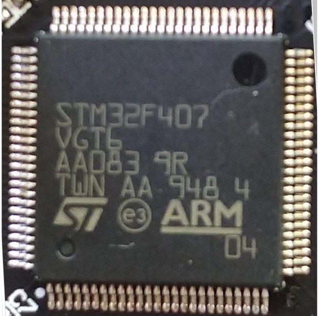

Is there a date code on the chip ? Maybe these cheap chinees boards are manufactured using a batch ST dumped ?
Posted: 03:17pm 27 Aug 2020
Here's what the chip looks like, but I don't know what it might tell me:
Posted: 05:58pm 27 Aug 2020
Ouch - that's a VGT i.e. STM32F407VGT6 but the Armmite is for the VET6.
Er, I haven't looked the differences up!
Edited 2020-08-28 03:59 by JohnS
Posted: 06:19pm 27 Aug 2020
VG version is fine - just twice the FLASH. However there is something very suspicious about the pricing of these chips. Check this out and compare with a unit price of $10.51 from ST direct in volumes up to 500. The pricing of the VET board seems more possible - cheaper chip on a board that sells for more and made in huge volumes
Edited 2020-08-28 04:20 by matherp
