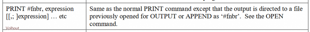

1/ According to the manual I should be able to write multiple variables in one print statement. I cannot get it to work.
I tried all options (variables separated by space, comma, semicolumn, combinations), see below program, but none seem to work except individual writes (print #). By the way, this problem also exists for individual reads (input #).
