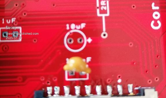

My question is regarding the 10 uF tantalum capacitor. Looking at the PCB, the marking just looks like a standard 10 uF electrolytic capacitor. So, what is the deal with the tantalum? What does it do in comparison with other capacitors and what does it do on the board?

The tantalum capacitor you are showing in the photo (or at least the place where it will go) is part of a filter circuit for the power to the SD card.

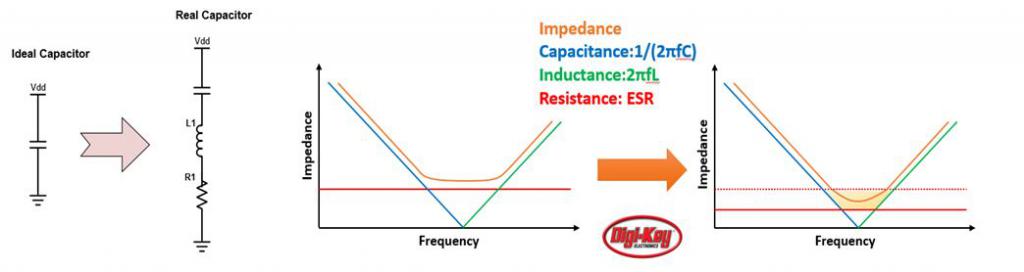

Tantalum capacitors have a lower ESR (Equivalent Series Resistance) than normal electrolytic capacitors.  In simple terms, this allows them to "respond faster" to voltage changes.  A perfect capacitor would have an ESR of zero, in the real world a capacitor acts like a capacitor with a resistor in series and also a small amount of inductance in the leads and structure of the capacitor.  For a 10uf electrolytic capacitor this would be on the order of several ohms.  For the tantalum cap it might be less than one ohm of ESR. The small 100nF ceramic capacitor next to it should have an extremely low ESR (i.e. less that 0.01 ohm)
On the CMM2, this capacitor will supply power to the SD card when the power demand of the SD card "surges".  The filter circuit prevents noise from the other components on the board from reaching the SD card.  It also prevents the power demand of the SD card from feeding back and affecting other components in the system.  This is sometimes referred to as "Decoupling" or "Bypassing"

That capacitor is there more as a precaution.  The CMM2 should run without it - if you don't want to wait.

Hmmmm.... given the 2.2 ohm resistor in series with the 3.3V supply to the SD card, not sure how well it would work without the 10uF capacitor?
Also, there are enough builders having problems with different SD card quality etc. so probably not a great place to cut corners.
The risk of damaging anything is low, so I guess it's worth a try, but I wouldn't get my hopes up about the SD card access working without the filter cap.  I haven't tried, so I can't say for sure!
If you are going to try without the 10uF tantalum I would definitely jumper across the 2R2 resistor.

The resistor came from the original Colour Maximite design where it was needed to prevent the insertion of the SD card from glitching the 3.3V rail.  There was no bypass cap in that design and it was not needed (there is a bypass cap already in SD cards).
The resistor in the CMM2 design was included as a precaution and the two bypass caps as a further precaution against glitches.  The CMM2 will run fine without the 10uF cap and you will certainly not damage anything - it is there as a precaution, nothing more.

I've had one running with a 100nf cap and no series resistor on the test CMM2 and many other devices. The commercially available populated SD card interface boards, that's the ones with a regulator and level convertors, have a 100nF bypass to stop regulator instability. The 3.3V rail in the CMM2 is already well protected and bypassed. SD card problems are not generally a result of a supply problem unless it's incredibly dirty or taking a dive at power up during the initialisation period, neither appear to be the case with the 3.3v regulator in the WS board, and your external 5v source would have to be total crap if the 3.3v volt regulator cant filter it. The risk of damaging anything without the cap is ZERO.
