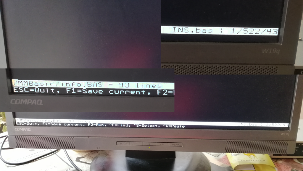

There's another party pooper bug I discovered yesterday, I'm trying to reproduce the error but it didn't re-occur yet.
I was messing around with the sprite command manually in prompt, first to get copies of the screen text "as sprites" (the last number when set to 0 makes it copy the source from the sprite from the screen to the sprite), then I set it to one without having a sprite file, which displayed a garbled sprite (pretty much like it does on a commodore 64, because it takes it from memory then, which is okay ...or so I thought).
Then I wrote a small sprite program with it, and after running it - it would not let me run it as it said "line to long error" or something similar (I've erased the file on the SD card because the file sprite.bas became corrupted and suddenly exploded in size from 1kb to 29kb on the CMM2 itself.
I couldn't even F4 (edit) it, as it would give me the same error message, line too long, so I took it to the PC to study where it went wrong, but it just looked like ASCII code gibberish.
What went wrong, I have no real concept of, but what I did was exactly as I described above.
The program worked fine until I made one small change like adding a variable to the sprite code.
sprite 1,1,dx+40,400,40,40,1
The variable before that was only dx=dx+1
the above sprite command in the program was
sprite 1,1,40,400,40,40,1 before that, and ran just fine, albeit static ofc.
I tried reproducing the scenario today, but couldn't.
Since then, I've written this as a small test, but it works fine:

  Quote   I'm trying to reproduce the error but it didn't re-occur yet.
Without a reproducible sequence there is nothing I can do

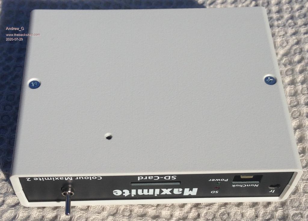

Hi all,
Just yesterday I installed a little slide switch (Jaycar, SS0834 but RS do them too).
A 3mm hole in the base allows me to slide it with a jeweler's screwdriver.
I'll now check out Peter's new approach.
(Edit: I've easily updated the firmware and am starting to play with Peter's changes - incredibly comprehensive. Many thanks to you all - A)
