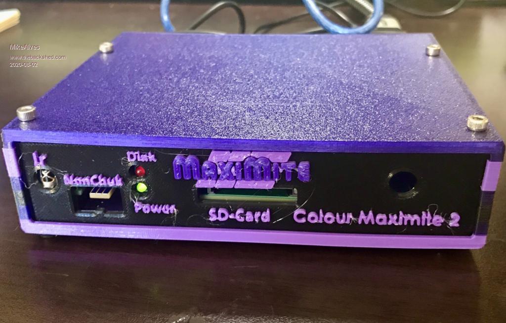

I too looked for 3D printed options for my brand new CCM2. I didn't see the first one but I did get Shadamus's design on thingivers.
https://www.thingiverse.com/thing:4558625
This is a rework of the front panel STL provided by the Colour Maximite 2 (CMM2) team in their Construction Pack zip file (get it from the bottom of Geoff's Maximite page
https://geoffg.net/maximite.html
The back panel for the case can be found at the above link. I did not chnage anything on it.
I reworked the front panel by combing the graphics files with the supplied front panel .stl so that the text could be extruded and printed a different color. I also changed the SD label of the the SD read light to say Disk because it thought it was more desctriptive and harkens back to the days of 80s era computers.
When I printed it, the resolution of my printer could not pick up all of the small diagonal lines of the MaximMite logo. I might redo it at some point, but I thik it looks cool anyway. If you want to try a highier resolution printer, see print settings.
The rest of the case (sides, mounts, etc) come from the excellent design of Shadamus.

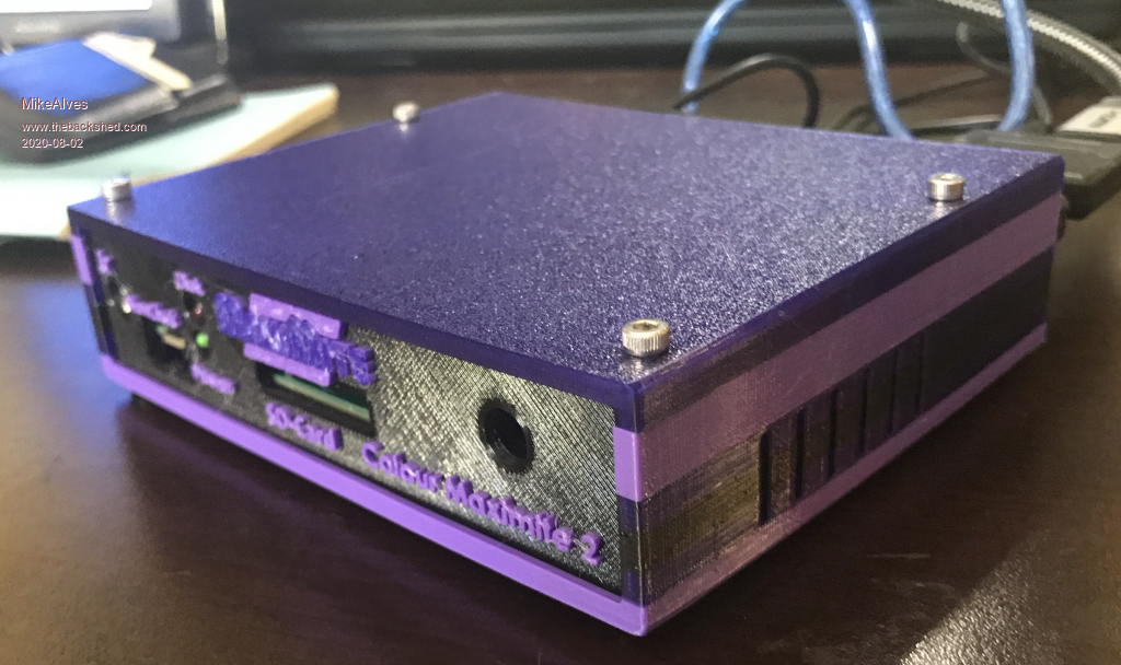

I like the surface finish on top, was that a special setting?
MikeAlves
Joined: 29/07/2020
Posts: 16
Posted: 11:40pm 01 Aug 2020
Thanks. That textured look comes from the surface of the printed bed itself. So, you can only get it on the surface that touches the build plate.
I love it. I have completely redesigned parts so that the prominent surface prints on the textured bed.
I have a Prusa MK3s printer.
