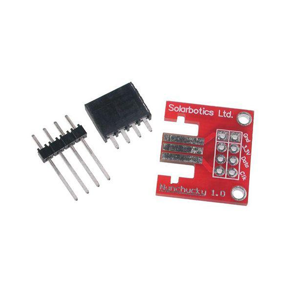

I did have a look here two nunchuk adapter
 Even four and eight port adapters can be made with the same chip familey.
 I think the best part is the base nunchuk code should work for the other
 nunchuks just need to point to the one being read.

OOh, interesting.. But I think we also want it to support the Wii Classic Controllers and it sounds like that one only handles the Nunchucks (based on the number of buttons and axis they're talking about). It's the same connector but likely some additional circuitry...
That said, if somebody were to make such a thing I'd likely buy one!

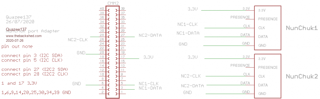

Maybe if I restate it again clearly.  I just want a pin to pin diagram to wire up the two other fmale WII ports directly available on the GPIO connector on the back.  All we need for 3 numb chucks or Classic controllers is the three female ports to plug them into(the one on the front and the two on the GPIO pins. OR AM I WRONG?  The manual says there is provision to use three but I can not find a simple wireing diagram to connect a 40 pin cable to 2 ADITIONAL female port or tells if you need resistors on any of those link-ups?  We don't need any additional programable chips if we use Numbchucks and clasic controllers(or in the case of my custom fighting stick,the guts and cable of a 3rd party crap contorler) and we also get an already provide standard way to use controller input in our games. Once again or am I worng. Can anyone please clarify this for me or point me to a helpful resource? the manual just says you can use 3. Maybe the manual should have a very simple diagram showing how to connect those 2 WII ports to the GPIO connector.  I do not want to fry my new CMM2(when it gits here) or my controllers. I Think the manual says that if you plug in a Numchuck upside down in the front port it might damage the controller or the CMM2(if yours comes in a full case you will neve see the legeons and warning on the PCB).  I plan to glue a restrictor tab in that port hole in the cutout made by the manufacture if mine did not have the foresight to key the hole to prevent upside down insertions.  I advise that you check yours and do the same. It only takes a moment's inattention to fry you equipment. Nintendo is great at idiot-proofing their equipment and we should take advantage of their inbuilt protections. The WII connectors are keyed for the protection of the devices but if your ports do not have the restrictor tab you can easly insert it upside down.  My choice to use extentions cable female connectors will provide the keying as well for the two on the back. I intend to use a full 40pin IDE cable so it's locking pin will extend the idiot-proofing to that connection as well.  These simple things are there to protect us from simple mistakes that can cause a lot of damage.  Thanks for any help you can give me on the wiring diagram.
Posted: 07:11am 26 Jul 2020
  mclout999 said  Maybe if I restate it again clearly.  I just want a pin to pin diagram to wire up the two other fmale WII ports directly available on the GPIO connector on the back.
Page 10 of the CMM2 manual has the pinout for the 40 way connector.
To use a nunchuk on I2C 1 you :
connect pin 3 (I2C SDA) to the DATA pin on the nunchuk
connect pin 5 (I2C CLK) to the CLOCK pin on the nunchuk
connect pin 1 (or any other 3.3V) to the VCC on the nunchuk
connect pin 9 (or any other GND) to the GND on the nunchuk
Also connect a 10k ohm resistor from pin 3 to 3.3V and
connect a 10k ohm resistor from pin 5 to 3.3V
To use a nunchuk on I2C 2 you:
connect pin 27 (I2C2 SDA) to the DATA pin on the nunchuk
connect pin 28 (I2C2 CLK) to the CLOCK pin on the nunchuk
Also connect a 10k ohm resistor from pin 27 to 3.3V and
connect a 10k ohm resistor from pin 28 to 3.3V
Posted: 07:45am 26 Jul 2020
Minor correction to Jim's post. The 10K pullups are already built into the motherboard or mainboard designs so no extra resistors needed

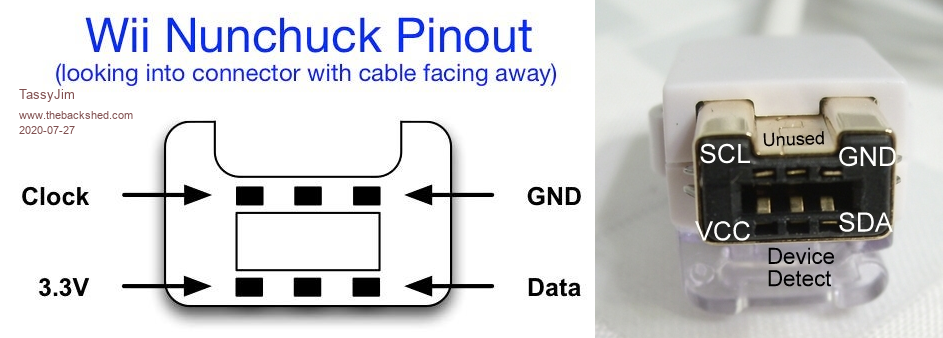

here ya go
