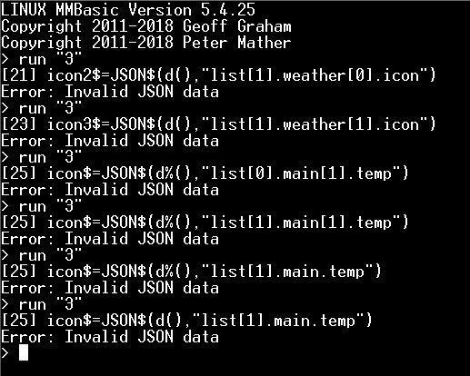

I'm stuck with this, I've been trying to work it out for 4 weeks trying various combinations of code but I cannot get it to work
DIM STRING p$=chr$(34)
Dim INTEGER a(90000)',k,l
dim time1$
system "wget -q -O- "+p$+"https://swd.weatherflow.com/swd/rest/observations/station/10170?api_key=20c70eae-e62f-4d3b-b3a4-8586e90f3ac8"+p$,a()
time1$=JSON$(a(),"obs.timestamp")'time received
print time1$$
This is what I get when I run the program
What  the query returns as you can see if you type http://swd.weatherflow.com/swd/rest/observations/station/10170?api_key=20c70eae-e62f-4d3b-b3a4-8586e90f3ac8 click me to see
What I'm trying to do is parse the bottom section of this
{"station_id":10170,"station_name":"Haughton Green","public_name":"Haughton Green","latitude":53.44007,"longitude":-2.10608,"timezone":"Europe/London","elevation":97.8037109375,"is_public":true,"status":{"status_code":0,"status_message":"SUCCESS"},"station_units":{"units_temp":"c","units_wind":"mph","units_precip":"mm","units_pressure":"mb","units_distance":"mi","units_direction":"cardinal","units_other":"metric"},"outdoor_keys":["timestamp","air_temperature","barometric_pressure","station_pressure","sea_level_pressure","relative_humidity","precip","precip_accum_last_1hr","precip_accum_local_day","precip_accum_local_yesterday","precip_minutes_local_day","precip_minutes_local_yesterday","wind_avg","wind_direction","wind_gust","wind_lull","solar_radiation","uv","brightness","lightning_strike_last_epoch","lightning_strike_last_distance","lightning_strike_count","lightning_strike_count_last_1hr","lightning_strike_count_last_3hr","feels_like","heat_index","wind_chill","dew_point","wet_bulb_temperature","delta_t","air_density"],"obs":[{"timestamp":1595169879,"air_temperature":16.8,"barometric_pressure":1010.4,"station_pressure":1010.4,"sea_level_pressure":1022.7,"relative_humidity":54,"precip":0.0,"precip_accum_last_1hr":0.0,"precip_accum_local_day":0.0,"precip_accum_local_yesterday":3.186342,"precip_minutes_local_day":0,"precip_minutes_local_yesterday":309,"wind_avg":2.1,"wind_direction":294,"wind_gust":3.3,"wind_lull":1.2,"solar_radiation":301,"uv":4.08,"brightness":36142,"lightning_strike_last_epoch":1594307075,"lightning_strike_last_distance":20,"lightning_strike_count":0,"lightning_strike_count_last_1hr":0,"lightning_strike_count_last_3hr":0,"feels_like":16.8,"heat_index":16.8,"wind_chill":16.8,"dew_point":7.4,"wet_bulb_temperature":11.7,"delta_t":5.1,"air_density":1.21395}]}
Which is my weather station, so I can use MM to display it properly
As the bottom section is preceded by "obs": I thought I could use that
but its never simple or easy

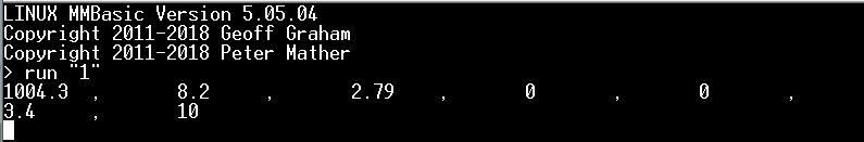

Can anyone see what I'm doing wrong?
I'm trying to parse the data using comma separated values
I'm pretty sure it's something really simple I've missed but I've spent the past 10 hours trying to get it working but it's eluding me
I'm receiving data from Weatherflow online using my station id and trying to parse some of the elements
I've commented out sections so only the first observation is trying to be parsed at the moment
Before I tried to parse the separate fields it was all working fine.
This is the error I've spent ages trying to fix

AirObs$ is string, not array of strings. If you need first element CSV, you need
press1$ = FIELD$(AbsObs$, 1, ",")
Jiri
jirsoft
Joined: 18/09/2020
Location: Czech Republic
Posts: 533
Posted: 05:29pm 25 Nov 2020
But to me looks like pressure is second element, so
press1$ = FIELD$(AbsObs$, 2, ",")
Jiri

Thank you so much
Working perfectly now
Sent data to HC-12
Received data from PC via HC-12
I'm hoping the spaces between the commas on the receiving micromite once it's set up won't cause a problem when it comes to parsing
Edit: I spent over 2 weeks trying to extract that information using Python from a Pi that's got a weather display attached
I did it using Pi-Cromite in a day
It would have been a couple of hours if I hadn't messed the field$ up
