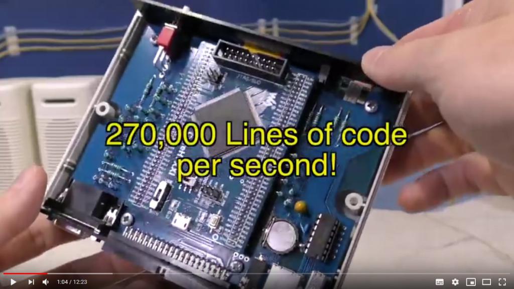

Posted: 02:16pm 16 Jul 2020
https://www.youtube.com/watch?v=IA7REQxohV4
This Guy apparently just took it from here.
  Quote  Full featured BASIC interpreter with double precision floating point, 64-bit integers and string
variables, long variable names, arrays of floats, integers or strings with multiple dimensions, extensive
string handling and user defined subroutines and functions. Typically it will execute a program at
270,000 lines per second.
Colour Maximite 2 User Manual - Page 4
And we need to know how Geoff measured it practically, to have a standard-code for an objective benchmark!

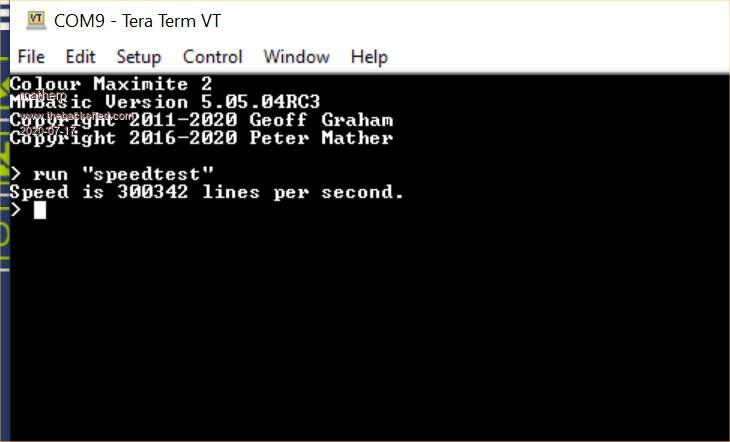

Posted: 03:56pm 16 Jul 2020
If you download the latest version
http://geoffg.net/Downloads/Maximite/CMM2_Beta.zip
and make a tiny change to the benchmark
' speed test
' will test and report the speed of MMBasic
dim integer i,cnt
SETPIN 3,2 : SETPIN 5, 8
lines = 5
loops = 1000000
TIMER = 0
' start of the timed section (5 lines)
FOR i = 1 TO loops
 inp = PIN(3)
 PIN(5) = inp
 cnt = cnt + 1
NEXT
PRINT "Speed is"; INT((loops * lines)/(TIMER /1000)); " lines per second."
You can now get 282000 lines per second
Posted: 07:03pm 16 Jul 2020
Coming in RC4

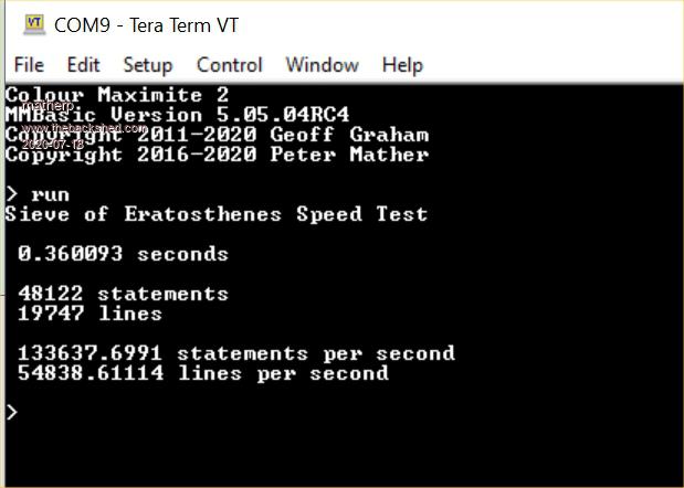

Posted: 01:49am 17 Jul 2020
here is a rather classic speed test:
Print "Sieve of Eratosthenes Speed Test"
Print
Start = Timer
10 W=500:Dim F(W):P=1:A=3
20 F(P)=A:P=P+1:If P>W Then GoTo DONE
30 A=A+2:X=1
40 S=A/F(X):If S=Int(S) Then 30
50 X=X+1:If X<P And F(X)*F(X)<=A Then 40
60 GoTo 20
DONE:
Elapsed = (Timer-Start)/1000
Print Elapsed " seconds"
Print
I = 0 ' statement counter
J = 0 ' line counter
Erase F
110 I=I+4: J=J+1: W=500:Dim F(W):P=1:A=3
120 I=I+3: J=J+1: F(P)=A:P=P+1:If P>W Then GoTo FINI
130 I=I+2: J=J+1: A=A+2:X=1
Print ,P Chr$(13);
140 I=I+2: J=J+1: S=A/F(X):If S=Int(S) Then I=I+1: GoTo 130
150 I=I+2: J=J+1: X=X+1:If X<P And F(X)*F(X)<=A Then I=I+1: GoTo 140
160 I=I+1: J=J+1: GoTo 120
FINI:
Print I " statements"
Print J " lines"
Print
Print I / Elapsed " statements per second"
Print J / Elapsed " lines per second"
Print
> run
5.403 seconds
48122 statements
19747 lines
8906.53 statements per second
3654.82 lines per second
with a number of results for many 80's systems here:
http://www.retroprogramming.com/2010/01/8-bit-home-computer-benchmarks.html
and a compiled list:
How Fast Were Those Late 1970s Home Computers?
8-Bit Home Computer Benchmarks
computer model clock CPU time
TRS 80 model I with Level II Basic 1.77 MHz Z80 421s
Sinclair ZX Spectrum +3 3.55 MHz Z80A 388s
Tandy 102 2.40 MHz 80C85 367s
Atari 130XE (Atari BASIC Rev. C) 1.79 MHz 6502C 338s
Atari 800XL 1.80 MHz 6502 316s
Tandy 64K CoCo 2 0.90 MHz 6809E 271s
Commodore Plus/4 1.80 MHz 8501 267s
Sony F1XV MSX2+ (MSX Microsoft BASIC 3.0) 3.58 MHz Z80A 260s
Commodore C64 1.00 MHz 6510 254s
Commodore VIC-20 (Microsoft BASIC 2a) 1.00 MHz 6502 234s
TRS-80 Micro Colour Computer (MC-10) 0.90 MHz 6803 220s
Apple IIe Enhanced (Applesoft II) 1.00 MHz 6502 211s
Sharp MZ-731 4.00 MHz Z80A 182s
Commodore 128 2.00 MHz 8502 152s
Tandy 64K CoCo 3 1.79 MHz 809E 147s
Amstrad CPC464 4.00 MHz Z80A 140s
Acorn Electron 2.00 MHz 6502 138s
BBC Model B (BBC BASIC 2) 2.00 MHz 6502 101s
BBC Master (BBC BASIC 4) 2.00 MHz 65SC12 76s
(the below list compiled June 2017)
Micromite MX150 40 MHz mips M4K 6.86s
Micromite MX170 (Mk II) 40 MHz mips M4K 5.31s
Micromite MX470 (plus) 100 MHz mips M4K 2.96s
Micromite MZ2048 (extreme) 200 MHz mips M 1.12s
MMbasic on RPi Zero (JG) ARMv6 0.89s
MMbasic on RPi B+ (DH) ARMv6 0.67s
MMbasic on RPi Zero W (PM) ARMv6 0.63s
MMbasic on RPi 3 (DH) ARMv8 0.22s
MMbasic on RPi 3 (PM) ARMv8 0.19s
MMbasic for WIN32 2400 MHz i7 0.06s
from this thread:
https://www.thebackshed.com/forum/ViewTopic.php?TID=9686
rob   :-)

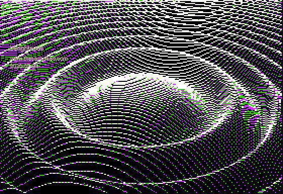

Posted: 12:58am 21 Jul 2020
Does the CMM2 processor have hardware math?  The horrible soul crushing experience with AppleSoft basic is that 6502 had no math above addition and subtraction, so doing something like this plot
takes several HOURS to draw.
Here's the applesoft code for this:
10 GOTO 40
20 XE = - X * S1 + Y * C1 : YE = -X * C1 * C2 - Y* S1 * C2 + Z * S2 : ZE = - X * S2 * C1 - Y *S2 * S1 + Z * C2 + RHO
30 SX = D * XE / Z E + CX : SY = CY - D * YE / Z E :RETURN
40 RHO = 30 : D = 350 : THETA = .1 : PHI = 1 : CX =140 : CY = 96 : S1 = SIN (THETA) : S2 = SIN(PHI) : C1 = COS (THETA) : C2 = COS (PHI)
50 DEF FN Z(X) = COS (.1 * (X * X + Y * Y))
60 HGR2 : HCOLOR= 3
70 FOR X = -20 TO 20 STEP .3
80 FL = 0
90 FOR Y = - 20 TO 20 STEP .07
100 Z = FN Z(X): GOSUB 20
110 IF SX < 0 OR SX > 279 OR SY < 0 OR SY > 191 THEN FL = 0 : GOTO 140
120 IF FL = 0 THEN FL = 1 : HPLOT SX,SY
