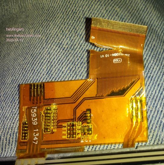

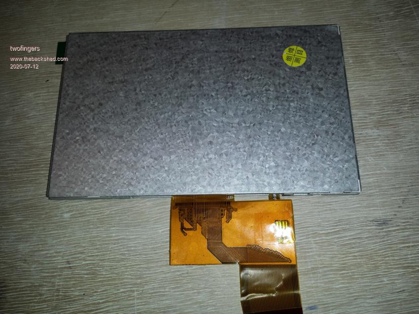

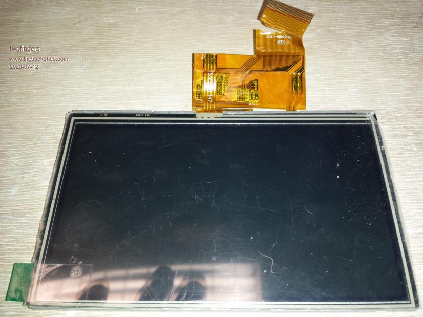

because my old one is damaged I am looking for a 5" LC display for the TFT Maximite.
What I need is a supplier and/or manufacturer number for the 5 inch version.

thanks for your advice. I haven't used the TFT Maximite in years. It was only loose in the drawer so I don't want to invest much. Today I finally printed a case for it and saw the damage.

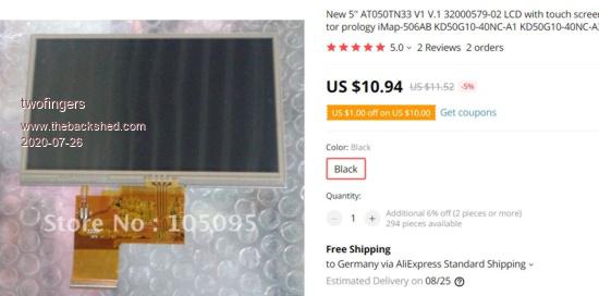

At the moment I tend to buy an AT050TN33 compatible display (9 €).

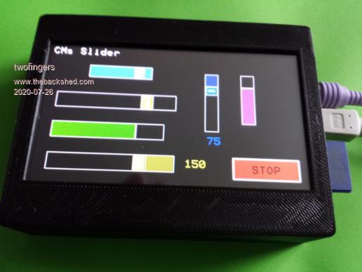

To whom it may concern:
The display arrived very well packed from china yesterday. So far as I have been able to test everything works perfectly - display and touch.
Cost: $ 10 including shipping.
Shipping time: 13 days.
