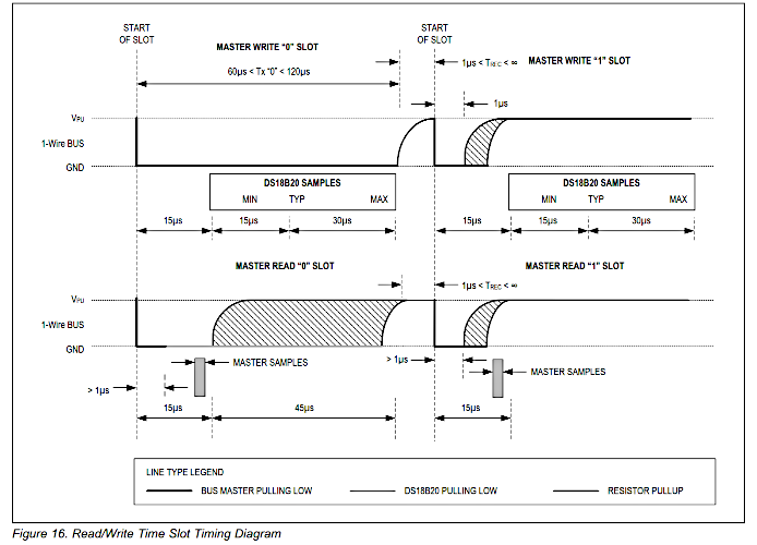

looks like i was wrong about the timing. from page 16 of the DS18B20 datasheet here:
https://datasheets.maximintegrated.com/en/ds/DS18B20.pdf
the following diagram suggests that the values used are pretty much right:
basically, while the DS18B20 may sample the bus at any time between 15uS and 60uS after the beginning edge of the negative pulse, the MASTER should read within 15uS of the beginning - which the MX170/470 version of mmbasic does do.
although it may still be worth tweaking that 8uS back to 6uS (when writing a "1" bit) to match the comment, just in case some 1-wire devices use the length of this pulse to set the timing elsewhere.
HOWEVER, i did have a look at the matching CMM2 1-wire code, and see the timing values (while within the right ballpark) vary quite a bit:
write "1" bit: 10uS low, 56uS hi-Z
write "0" bit: 65uS low, 5uS hi-Z
read bit: 3uS low, 10us hi-Z, READ, 53uS idle
but it could well be that peter has tweaked the values for good reason to match actual measured signals on the 1-wire bus.
