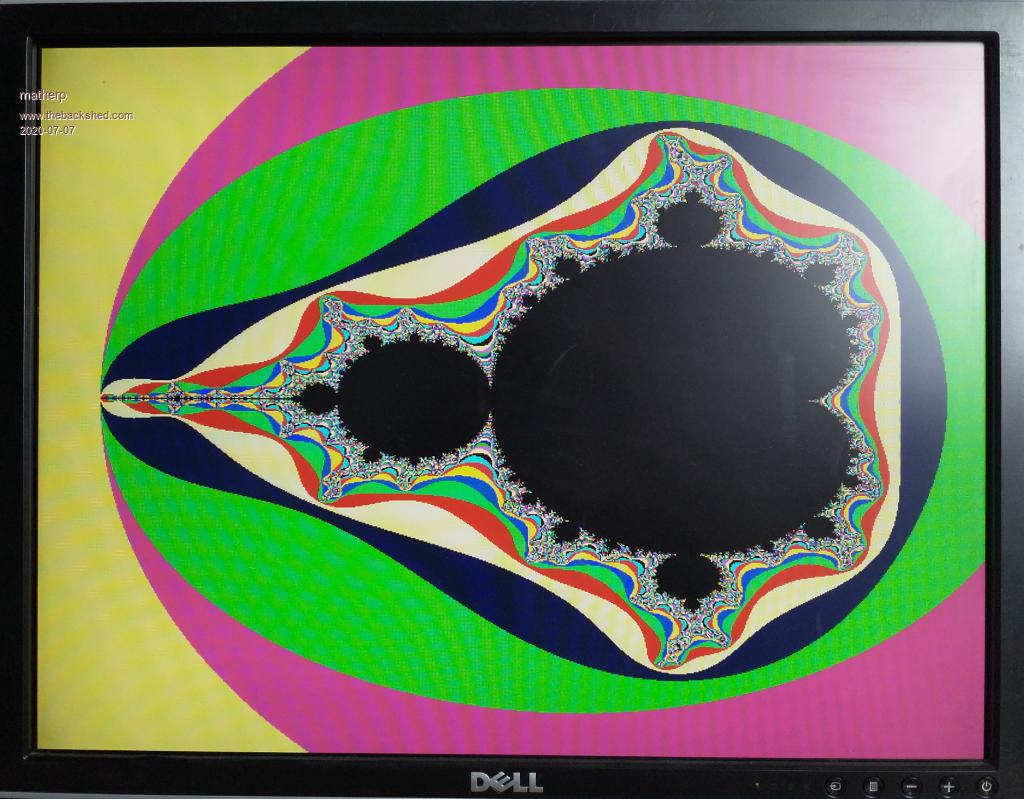

Takes 1.6 seconds to run 800x600
Video

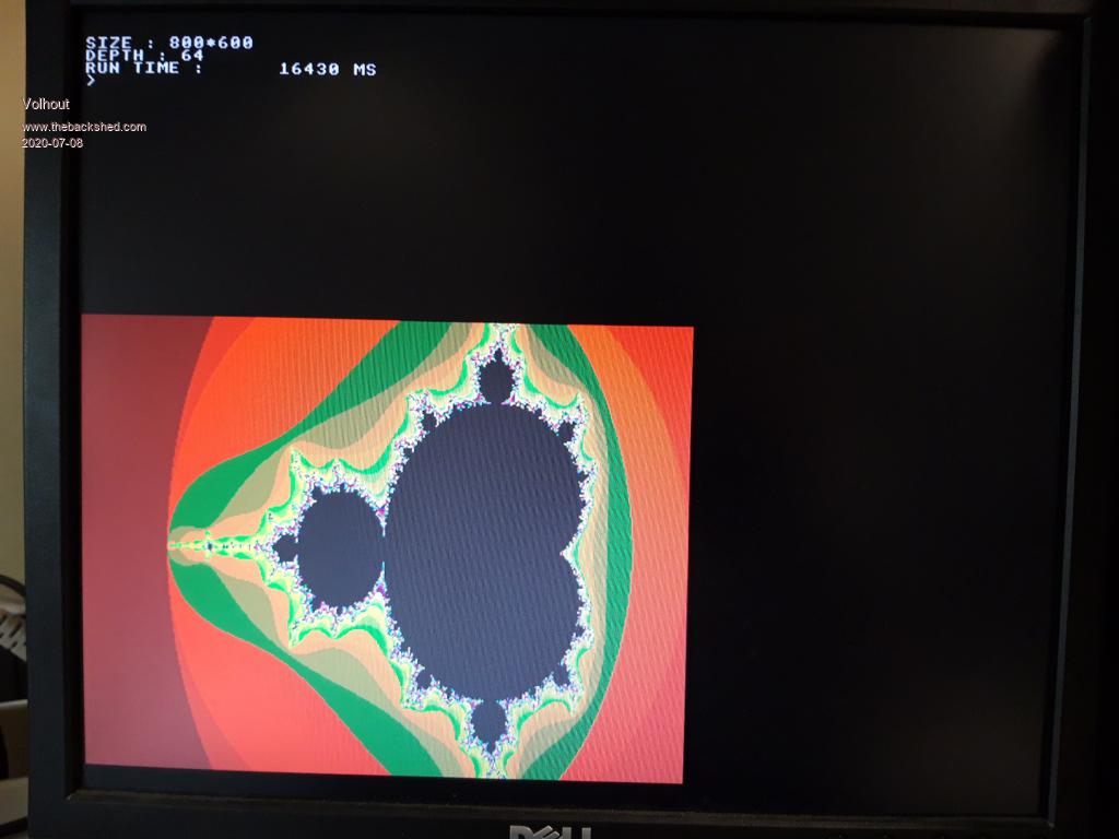

I had NO idea it was possible to do this on the CMM2.
This changes everything!
One of the first things I did was write a Mandelbrot plotter and mine works, but it is 10X slower at least as it is in 100% BASIC.  I also wrote a Conways Game of Life implementation and it works but once again, being 100% BASIC, it is slow.
So, exactlly how does this work, is there are tutorial or info as there is nothing in the user manual.
Thanks!

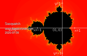

I took the liberty of tweaking Peters Mandelbrot CSub.  It now accepts scale and position coordinates.  I also inverted the Y display coordinates to be more standard. It's still pretty darn fast!
Edit:  You will need one of the latest beta versions of MMBasic to run this!
If someone wants to write a MMBasic UI to make it interactive that would be awesome.  I will get to it "someday" if nobody else volunteers!
The coordinate system looks like this:
Here is the MMBasic Code:

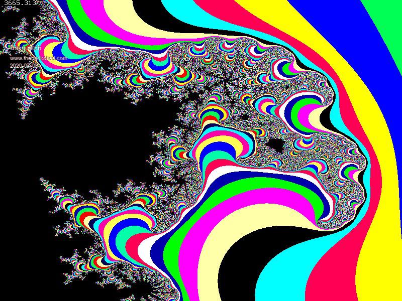

Here is an example screen dump.  As you can see in the uper left hand corner, it took 3.6seconds to render at 800X600.
Depth = 64
Scale = 50.0
XCenter = 0.3935871840
YCenter = -0.1475255520

Ported to BBC V basic running on the raspberry Pi zero.
MODE 28
w = 800
h = 600
maxi = 64
TIME = 0
FOR py = 0 TO (h/2 - 1)
 sy = (py / h) * 2 - 1
 FOR px = 0 TO w - 1
   sx = (px / w) * 3.5 - 2.5
   i = 0
   x = 0
   y = 0
   WHILE ((x^2 + y^2 < 4) AND (i < maxi))
     xt = x^2 - y^2 + sx
     y = 2 * x * y + sy
     x = xt
     i = i + 1
   ENDWHILE
   GCOL i/maxi * 64
   POINT px, py
   POINT px, h-py
 NEXT px
NEXT py
PRINT TIME*10
run time : 16 seconds (10x slower than the CMM2 CSUB)
