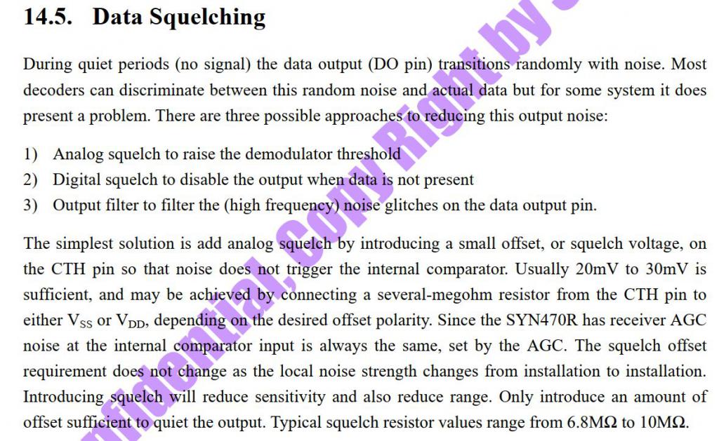

On the squelch, page 18 of the 470 receiver chip states:
My receiver modules have no connection to the CTH pin(7), so I could do as they suggest and add a 6M8 to 10M resistor from this pin to GND as a squelch experiment.
Also, pin 12(WAKEB) is defined in the manual as: "Wakeup(digital output): Active-low output that indicates detection of an incoming RF signal." - this pin is also not connected on the module I have.  I will solder a test wire to this, and analyse it along with the data signal, cos this could indeed provide the interrupt signal I need, and then I can just read the data bits somehow.

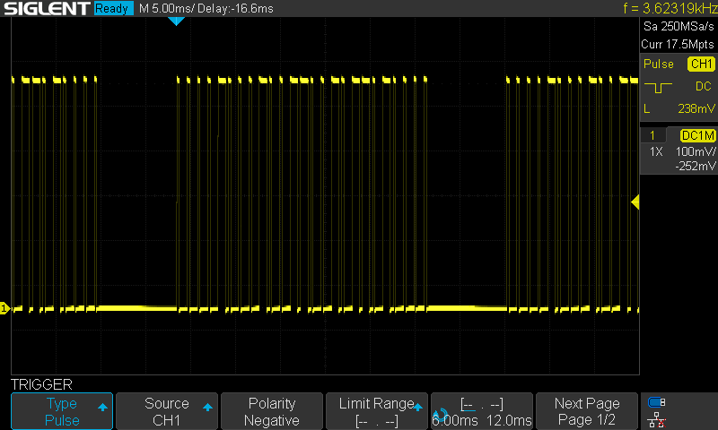

have some remotes and an SYN470R receiver module here, and just looking at a scope trace of what is going on.
in my case, i'm seeing a long negative pulse interval of a little under 9ms between code block. each block consists of 25 bits, with the first (start) bit='0':
code pulses are about 0.3ms (short) and 0.9ms (long).

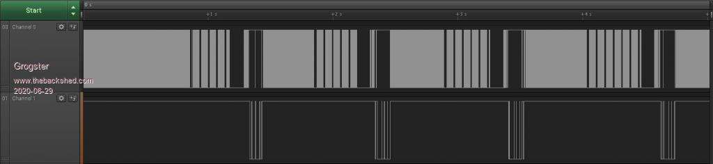

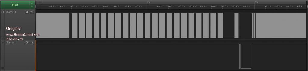

Posts: 10116
Posted: 04:18am 29 Jun 2020
Yes, the blank chip on the module I first played with is not a genuine chip.  I get nothing at all out of pin-12 when I solder a test wire onto that pin, but I DO get an expected response from another module that has a laser-engraved SYN470R marking on it:
Data on channel-0, WAKEB pin(12) on channel-1.
I do note that the pulses we see on WAKEB are at the END of the transmission, NOT the start as I would have thought.  To me, that does not make much sense, as the data has STOPPED by the time you get the pulse on WAKEB - so you have nothing but white-noise again.  Confused by the timing of the WAKEB pulse, as the manual for the chip says this is active-low on detection of an incoming RF signal, but it would seem to be active-low on detection of the END of an incoming RF signal.  Does this make any sense to anyone else?
Here is another shot, where I have keyed the transmitter four times with a gap between presses, and you can clearly see that the WAKEB pulses DO sync up with the RF, but they appear when I RELEASE the transmitter button, so they are indicating when I am letting go of the transmitter button, but not when the RF is actually detected so you can sync to the data - which is to the left of those pulses, on channel-0.
Confusing....
Here are the two logicdata files in a ZIP:
2264logicdata.zip
Edited 2020-06-29 14:21 by Grogster

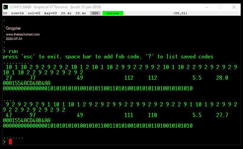

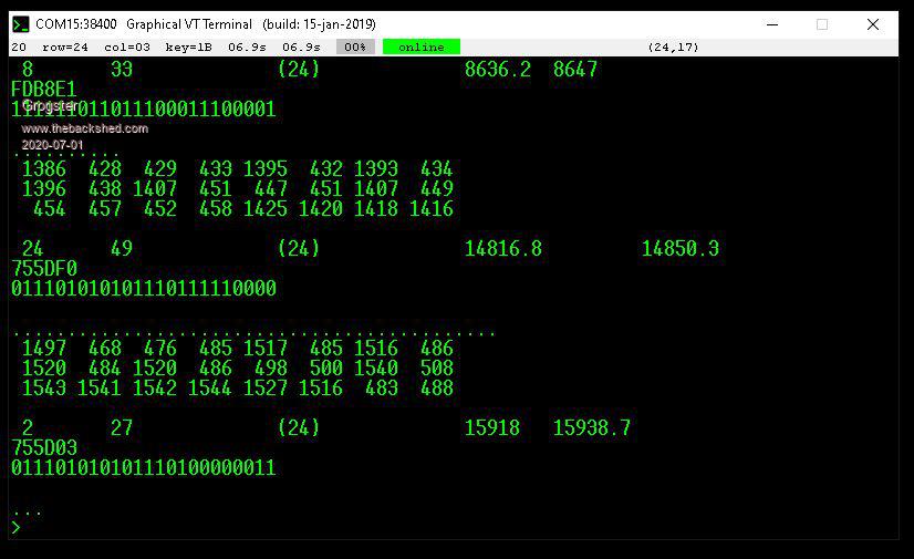

Posted: 07:44pm 30 Jun 2020
hi all,
   give the following a try. it runs (only just) on an MX170 and decodes both of the keyfobs i have here. it should also work for fobs with different numbers of data bits by editing or commenting out the line that reads "If (I2-I1-1)<>49 Then Print ".";: GoTo skip"
the timing should auto-adjusting. just hook up the output of your SYN470R module to pin 22. the 'getcode' routine could possibly be moved into a timer ISR with some benefit, or better still run on an E64 module. a really useful thing would have been a way to turn on/off all interrupts during the critical part of the code - something like CPU INTERRUPTS ON|OFF
the code is quite rough, but is a good starting point and proof-of-concept.
rob   :-)
CPU 48
Option break 0
SetPin 22, DIN
Dim times(150)
Dim keylist%(20)
Sub getcode
 state=0
 For I=0 To 148
   count=0
   Do :count=count+1:Loop Until (Pin(22)=state)
   times(I)=count
   state=Not state
 Next I
End Sub
' main program begins here
For I=149 To 150: times(I)=9999: Next I
For I=1 To 20: keylist%(I)=&hDEADC0DE: Next I
keylist%(15)=&h000077377777732A
keylist%(16)=&h00007737777772CA
keylist%(17)=&h000077377777734A
keylist%(18)=&h000077277777732A
keylist%(19)=&h00007727777772CA
keylist%(20)=&0000h77277777734A
Print "press 'esc' to exit, space bar to add fob code, '?' to list saved codes"
 Pause 500
 getcode
' find maximum time value, use 1/4 of this as threshold for start/end pulse
 tv=0
 For I=1 To 148:tv=Max(tv,times(I)): Next I
 tv=tv/4
' find beginning and end of a (possibly) valid code segment
 I=1
 Do While times(I)<(tv): I=I+1:Loop
 I1=I: I=I+1
 I2=I
 code%=0
 Print
' scan over code segment, find maximum and minimum values
 t0=+9999
 t1=-9999
 For I=I1+1 To I2-1: t0=Min(t0, times(I)): t1=Max(t1, times(I)): Next I
 av=(t0+t1)/2
 For I=I1+1 To I2-1
   Print times(I);
   code%=code%<<1
   If times(I)>av Then code%=code%+1
 Next I
 Print
 Print I1,I2,, I2-I1-1,, times(I1), times(I2),, Str$(av,0,1),Str$(tv,0,1)

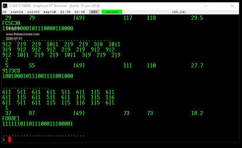

> RUN
1 5 1 5 1 5 1 5 5 1 1 5 1 5 1 5 5 2 1 5 1 5 4 2 5 1 1 5 1 5 5 1 1 5 5 1 5 1 1 5
5 1 1 5 1 5 1 5 1
1       51              49              19      73             3.0     18.2
0000AB2xxxxxx32A
0000000000000000101010110010101100101101001011001101001100101010
Edited 2020-07-01 05:49 by robert.rozee
