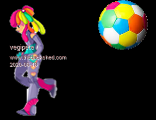

I just had a play and created the attached that (rather crudely) implements the above. I grabbed a set of images from the web and hacked together a test program. The animation is a sequence of 16 images but I use only one as a sprite. A piece of the image also provides a bouncing ball.
This demo shows also that I have more to learn about transparency.
SpriteTest.zip

@ vegipete: That demo is excellent!
