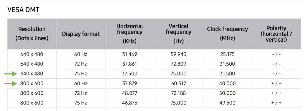

Assuming the CMM2 is putting out the standard VESA DMT (Display Monitor Timings) for these 2 output resolutions (800x600@60Hz & 640x480@75Hz), then you would assume that all HDMI capable displays should support these basic resolutions?
Unless there is perhaps some +/- sync polarity support issue?
The below supported resolutions table is from a recent model Samsung TV. Note that the 640x480 support is -/- sync polarity, whereas the 800x600 support is +/+ sync polarity.  Presumably these are the normal / expected sync polarities for these resolutions?  A quick look at the VESA DMT specifications did not appear to list specific sync polarity requirements for these resolutions (but I may not have read deep enough).

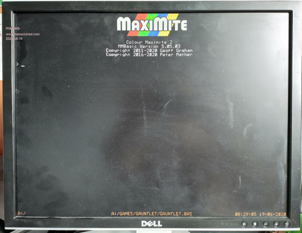

Posted: 08:45am 19 Jun 2020
@matherp
Exactly the same model I'm using. ~20". OK so far for what I done with it.
Upper vertical position swivel thingy needs tightening though.
How come yours is displaying just "Version 5.05.03"

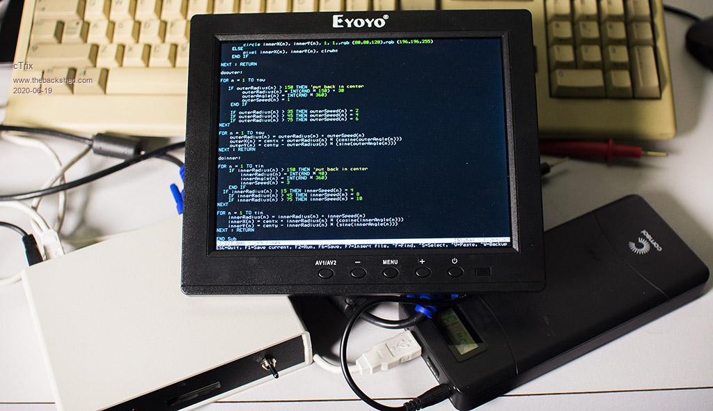

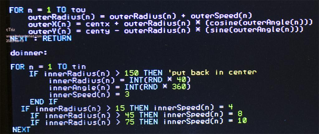

My little setup is one of three monitors.  Either the 2007FP (above!) or I also have 2 portable monitors, both branded "Eyoyo" and native 800x600.  I have the 10.4" and the 8" model.  Here's the 8" monitor (which is still fine to use size wise).
You'll notice I also have an Officeworks Comsol powerbank.  This has a 12v output so it can power both the Maximite and the Eyoyo Screen.  I get about 30 hours running both... and well over 100 hours just running the Maximite!  Great for when you just want to sit on the deck or take it camping.  Nothing quite like being in the wilderness... away from mobile reception... on a rainy day... smashing out some BASIC :-P
Text is very readable even on 8".  And it instantly switches modes, unless the Dell :-p
YouTube video coming soon btw.

How do the lower resolution modes look like on the Eyoyo, cTrix?
