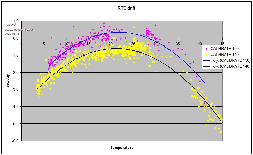

The RTC drifts with temperature:
The 8MHz Xal can be replaced with a 8MHz oscillator module but it is not going have  much better accuracy if any. We did this to improve video stability but by the time I did one of mine, Peter had solved the problem and the transplant is no longer required.
