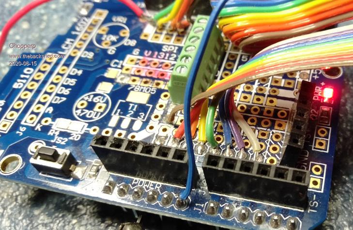

OK, found the problem.
One of the ribbon cable wires I had soldered to the I/O pin pads was just touching the 5V bus running past the row of pads (A3 pin). Must have melted too much insulation when I soldered it on. Measured about 3-2 ohms when tested today but would have been intermittent etc depending on how much downwards pressure was on the cable.
Would have been like that for a good few years.
(I cut the ribbon cables, leaving them attached to the offending shield when I reconnected them up the other shield. They were a bit too long anyway & needed tidying up. I used terminal blocks this time around)
Brian.

Chopperp
Joined: 03/01/2018
Posts: 1131
Posted: 12:03am 15 Jun 2020
FYI
The green covered wire in the foreground was the offender.
The row of holes behind the cable are 5V
Brian
