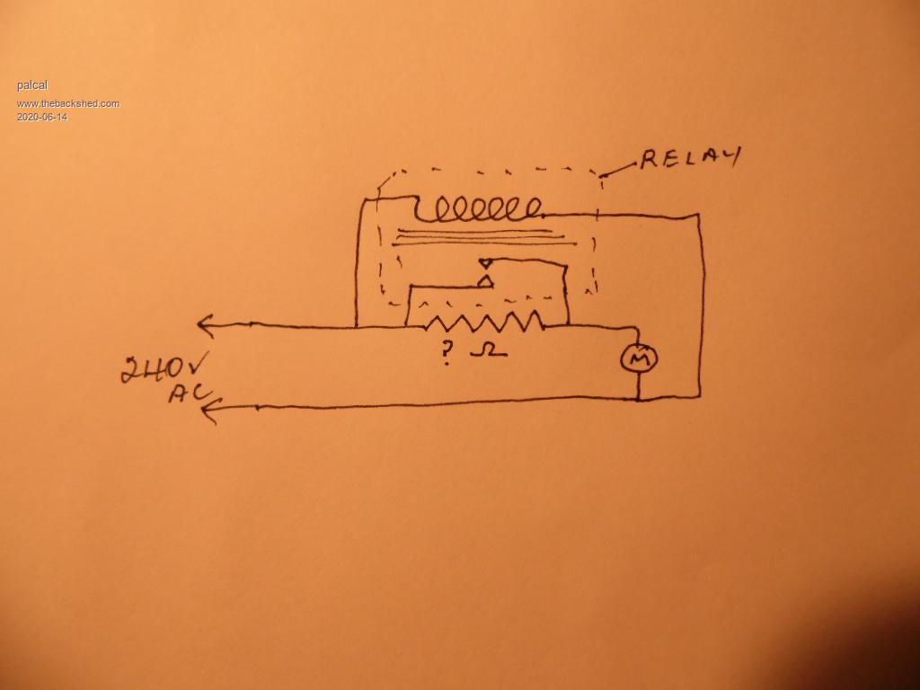

  palcal said  I used the resistance idea on a much smaller scale to start a fridge running off an inverter.
Can you provide a circuit diagram?

@ Lizby
      A very rough diagram
Sorry about the size.  The resistor has to be chosen to suit the supply, so if you have 5 amps available you could use say 50 ohms. The wattage has to be large but not the calculated wattage as it is only in circuit for a fraction of a second. As I said I used it on a small scale to run a fridge that only drew .8 amps but still overloaded my generator on start. The resistor only has to be in circuit until the back EMF is generated by the collapsing magnetic field in the motor winding.
In Paul L's case he would need a fair lump of a resistor, and it probably would not be possible. Delaying the relay for maybe a second would also help.

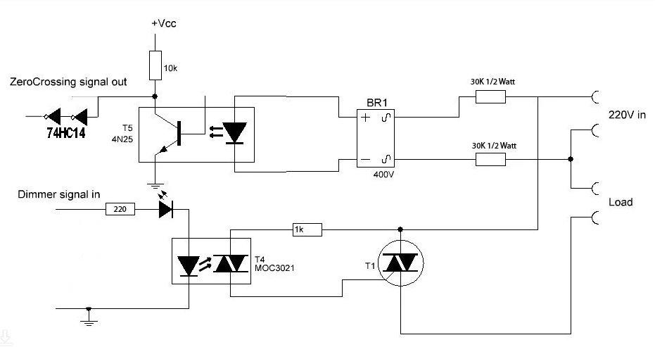

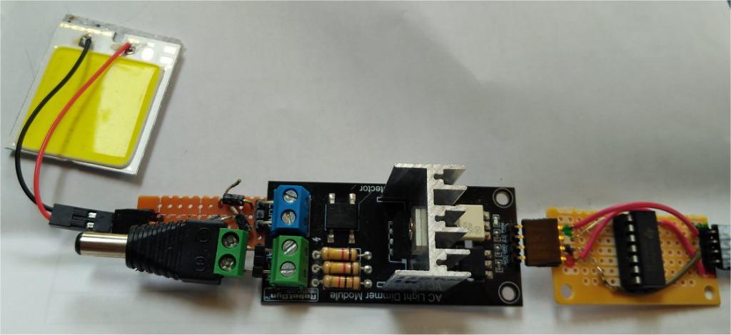

Here's proof of concept for an AC "cycle slicing" process using a PICAXE 08M2 and an ebay/amazon/aliexpress zero-crossing + triac control module:
AC dimmer module
Mains frequency here in North America is 60Hz, so there are 120 zero crossings (for half cycles) per second. This means that each half cycle is 8.33ms, so time-slicing after the zero-crossing detection has to be within that time frame.
I happened to have an old 12V AC wall plug transformer, which made testing safe and easy. It turned out the module detected zero-crossing with no problem using that transformer.
I found what appears to be the circuit diagram for the module here: https://www.instructables.com/id/Arduino-controlled-light-dimmer-The-circuit
(I added the two gates on a 74HC14 schmidt trigger inverter to sharpen the zero-crossing signal.)
For the PICAXE, I set the frequency at 16mHz instead of the typical 4mHz. This means that the PAUSE 1 command which normally pauses for 1ms actually pauses for 312us. Increasing to PAUSE 2 adds 250uS; the same for additional pause times. So I started with a pause just short of the 8.33ms after zero-crossing, and then fired the triac. I reduced the pause time after a certain number of half-cycles--32 half-cycles with the same pause and 26 250us steps gave me about 4 seconds to ramp up to nearly full on (at which point with a big motor, you would switch on a relay or SSR to provide full current).

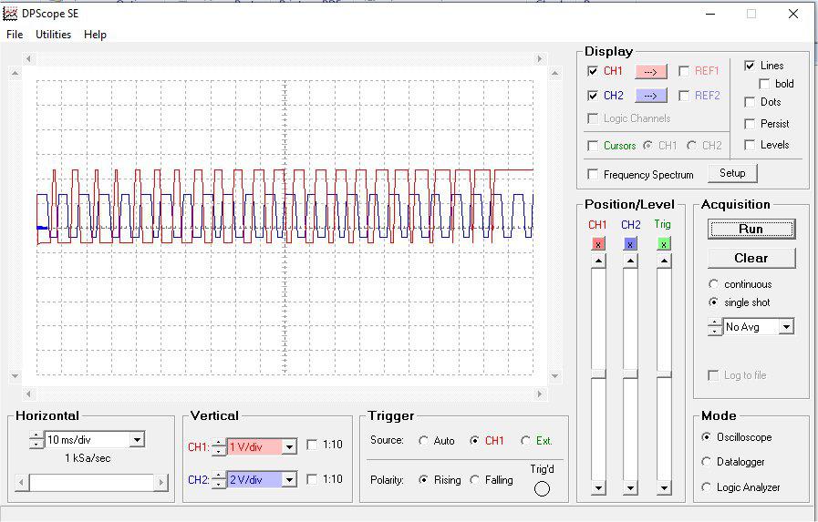

Here is what it looks like on my PC scope, DPScopeSE, the on-time ramped at each zero-crossing; the zero-crossing trigger is blue, and the on-time is red.
Here's the code with the approximately 4-second ramp.

I added a full wave bridge to the output of the module, and put on a 12V LED as load. The brightness ramps up over 4 seconds (though it's not dramatic). With a DVM attached the reading rises from 0V to 16V.
Here's a youtube video
