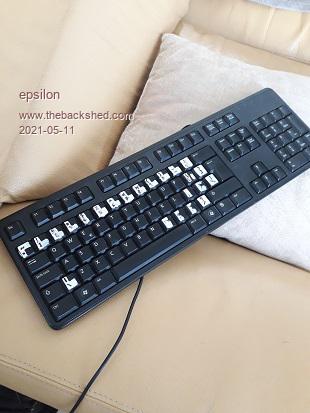

Posted: 07:13am 11 May 2021
This is the route I took with my Belgian keyboard :-)
It needs a new paint job. It gets used a lot :-)
Epsilon CMM2 projects
