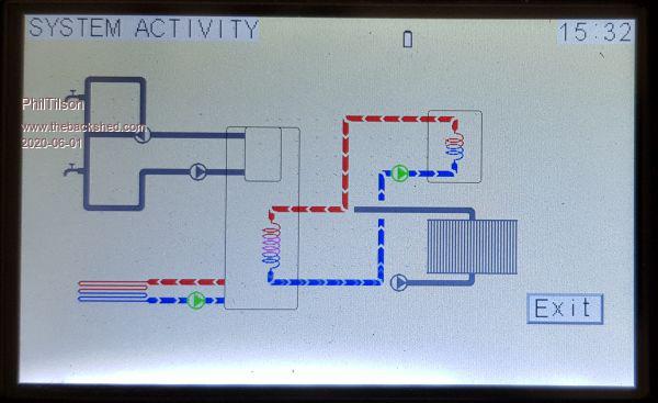

I am using a MM+ as a central heating controller.  From the 'main menu' screen I can select a number of options - setting up the DHW, setting up the CH and a 'mimic' display (of which I actually posted details on here many months ago!).
My problem is this: I use the PAGE facility to set up different sets of controls for the different functions.  As I switch from menu to menu I load different pages and this all works perfectly, except...
When I load the mimic diagram for the first time, I get the 'Exit' button, and the various hotspots on the screen work as intended - clicking on a pump turns it on or off etc.  Clicking on the Exit button returns me to the main menu.  However, when I next go to the mimic screen, there is no Exit button and no hotspots on the screen, and I don't understand why this should work the first time but not subsequently.

Setting up the mimic page:
GUI SETUP 5 'Display the system diagram screen
FONT 9,2
GUI CAPTION #hdr4,"SYSTEM ACTIVITY",5,16,"LMN",blk,wht
GUI AREA #btnDHW,216,192,24,24
GUI AREA #btnBoiler,480,192,24,24
GUI AREA #btnUFH,216,360,24,24
GUI AREA #btnPri,480,336,24,24
GUI BUTTON #btnExit,"Exit",660,360,100,40,blk,lgy

For the benefit of those who may have been interested, the problem occurred when exiting the mimic page. To clear the screen prior to writing back the main menu, I used the CLS command.  It would seem that using this command actually deletes the GUI controls on the screen, and they cannot be resurrected by simply using the PAGE command.  I must admit, I do find this a little odd (or am I misunderstanding something?)
Problem solved by removing the CLS command and instead writing over the diagram with spaces.  (The original diagram is created using a custom font of the various symbols and lines.)
