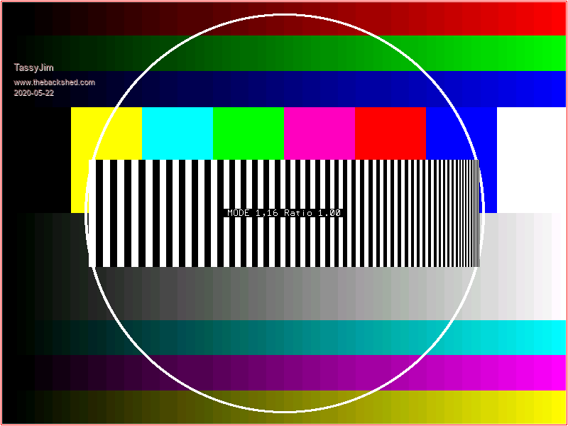

ColourBars is a short program to test all available graphics modes.
It can be tricky to set up a monitor to display all modes without trimming off pixels from one edge in some modes.
This program helps.
It also lets you find the optimum aspect ratio needed for the CIRCLE command. This will vary between monitors.
colourBars.zip

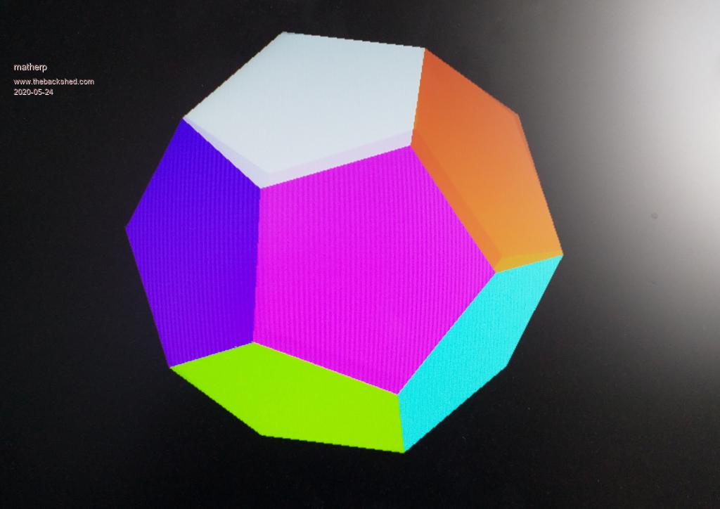

Rotating Dodecahedron
Check the video

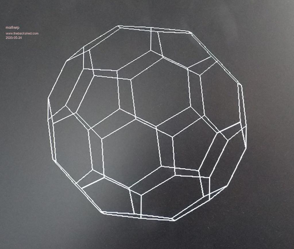

Rotating wire-frame bucky ball
Video

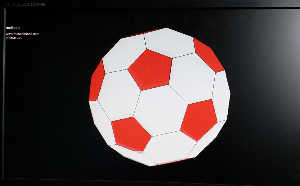

Posted: 06:16pm 24 May 2020
Last one of these more as a proof of the absolute performance of the CMM2 than anything useful - 60 vertices, 32 faces full perspective projection using Painter's algorithm to establish face order. Time for each iteration 85mSec despite a huge amount of maths being done
Watch the video

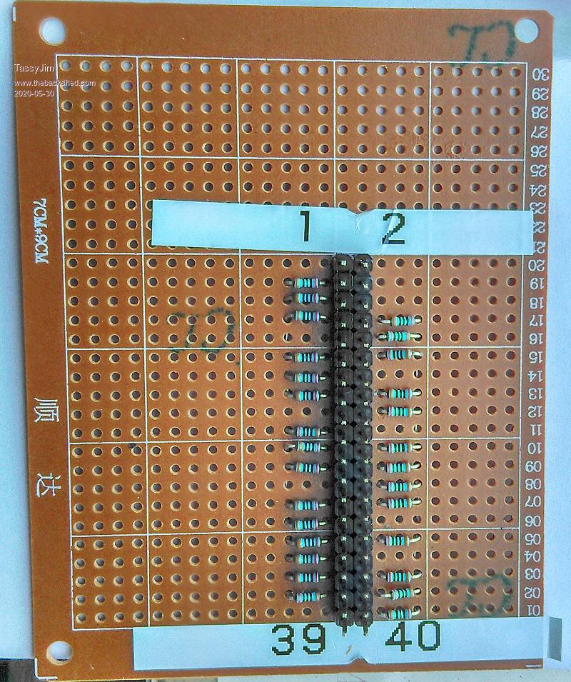

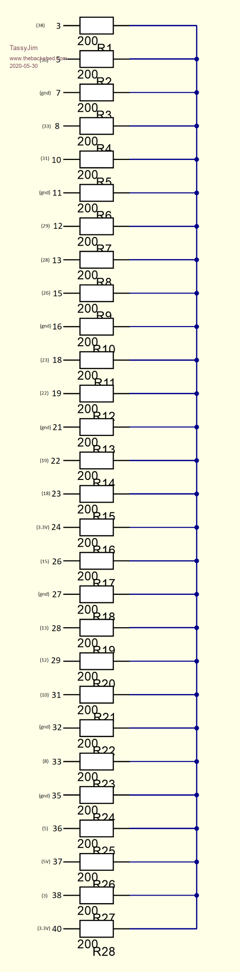

Not a demo - more a test but I had to put it somewhere.
This tests the wiring of your 40 way connector.
It needs 28 resistors of the same value. I used 200 ohm but anything from 200 to 2k should do the job.
It first checks to see if the cable is the right way around.
Then we test all digital IN and digital OUT.
The analog in is tested by setting one digital OUT high and one LOW to give a voltage at VCC/2.
My fist go was on a breadboard then I got creative with the soldering iron.

Posted: 11:10am 30 May 2020
Are the outer leads of the resistor all ganged? That is what I appear to see through some of the aligned holes.
Posted: 12:23pm 30 May 2020
  lizby said  Are the outer leads of the resistor all ganged? That is what I appear to see through some of the aligned holes.
Yes
As per the comments in the code
  Quote  ' requires a bank of 28 same size resistors (I used 200 ohm)
' connected from each pin in pintest() array to a common point
I should have been clearer.
In the circuit, the numbers in brackets refer to the pin numbers when the cable is arse about.
Posted: 01:28pm 30 May 2020
  Quote  Are the outer leads of the resistor all ganged? That is what I appear to see through some of the aligned holes.
' requires a bank of 28 same size resistots (I used 200 ohm)
