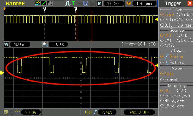

On a MicroMite Mk2 28 pin 170, has anyone had any joy getting the SPIPort routine in the Embedded routines in the firmware pack working? (can't use the normal SPI port).
I have something very odd happening whereby I am getting  the CS pin oscillating even when I have stopped the program and am at the > prompt.
Here is my sub to talk to the chip:
Sub MAX7221(MAX7221Dat As Integer)
Local Integer j
Pin(CS)=0 'CS Lo
j=SPIPort(2,DAT,CLK,MAX7221Dat,0,0,16)' 16 bits sent at 1MHz+
Pin(CS)=1 'CS Hi
End Sub
If I REM the line starting j= then I see the toggle from the CS pin, but if I un-REM it, I get the oscillation, even when my prog is not running. It starts up, makes a single call to the above Sub then ENDs, but that CS pin keeps waggling... at the > prompt(!).

It very much looks something is repeatedly calling your sub.  The CS low time is about 250uS which is about correct if the line starting j= is commented out.

I agree, but it is happening at the > prompt, which kind of points to some backdoor thing going on. Also, I call the routine once then end and it still continues.

Do you have a tick timer going off every millisecond?  That will keep running at the command prompt.
Posted: 08:17am 21 May 2020
Morning Geoff
No, no timers at all running. It is a mystery and definitely associated with the CFunction - if I REM it out, the problem doesn't manifest. I was checking for shorts and all sorts but it just made no sense. Maybe the HEX got corrupted when I copied it across or something.
