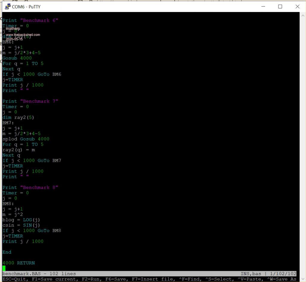

Putty works fine under W10
Check baudrate - must be 115200

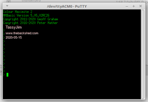

I don't have a PRi with monitor attached but I can use Putty on Linux OK
The CMM2 should appear as ttyACM0 not ttyUSB0 etc.
During enumeration, Linux might complain about "failed to set dtr/rts" but you can safely ignore that message.
I DO run a CMM2 off a RPi using ser2net (but not with the microchip serial port), so I do know that they work well.
