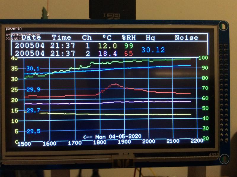

I developed some code that displays a continuously scrolling plot of the temp/RH data from two
Digoo's (one inside and one outside, ten metres away) and the pressure sensor. I've decided to post
this work in case members are interested in some of the methods I used with the uMite+ since I'm sure
in future there will deservedly be a lot of focus on the new STM based MM2.
The system has been running in my office for a couple of years now and it quite stable.
The system includes:
1. the uMite+ (MX470) running on Peter's original 'universal' backpack V1.1
2. a 4.2" 40 pin SSD1963 480x272 display. Smaller displays are generally a bit too 'busy' and
restrict scale range. The 320x480 ILI9488 3.5" would be a preferred choice and improve scale range.
3. a piezo beeper,
4. a battery backed DS3232 RTC,
5. the RX470 433 MHz receiver module and
6. the wired I2C BME280 barometric pressure sensor and two Digoo R8S temp/%RH sensors.
Items 3-6 are mounted on the backpack.
Features of the program include:
1. a continuous seven hour display updating asynchronously, approx. once a minute for each Digoo
and every half minute for the BME280.
2. scrolling the display using the BLIT command - actually a 'pseudo' scroll but still effective.
3. maintaining an updated time grid on the X axis.
4. auto-scaling (only on barometric pressure but simple to add to temp/RH).
5. noise checking (with display) all data using rolling averages.

 else
   temp$ = "-" +STR$(VAL("&B"+reverse(mid$(code$,17,12),12))/10,2,1)  'temp is -ve.
 endif
 relhumid$ = STR$(VAL("&B"+mid$(code$,30,7)))      'rec'd %RH is whole numbers.
 channel$ = STR$(VAL("&B"+mid$(code$,15,2))+1)
 curdate$ = date$: curtime$ = time$
 dattime$ = right$(curdate$,2)+mid$(curdate$,4,2)+left$(curdate$,2)+" "+left$(curtime$,5)
 info$ = dattime$ + channel$ + temp$ + relhumid$
 if info$ = oldresult$ then exit sub  'removes the Digoo 'triple' transmission.
 oldresult$ = info$           'holds current result for above comparison.
 plotdata                     'valid information (data), so display it.
end sub
function reverse(in$,len%)as string   'inverts binary string - credit to MikeO at TBS.
 local x%
 for x%=1 to len%
   if mid$(in$,x%,1)="1" then
     reverse = reverse+"0"
   else
     reverse = reverse+"1"
   end if
 next x%
end function
sub drawgrids
 cls
 FONT #2          '12x20 NB: all fonts have chr(96) "`" replaced by degrees symbol.
 text 0,0,"  Date  Time  Ch  `C  %RH  Hg    Noise",,2
 gridtop = 3*mm.fontheight   'gridtop = top of y scales. Allows 3 rows of Font #2.
 box 0,0,mm.hres,20: box 0,0,mm.hres,gridtop     'boxes for heading & current data.
 font #1          '8x13
 timescale        'Display the timescale
 tempRHscales     'Display the temperature & %RH scales
 pressurescale    'Display the BME280 pressure scale
end sub
sub timescale        'Vertical grid (X axis) & Timescale (24hr format).
 local integer j,basehour
 static integer nextbasehour   'STATIC holds variable between SUB calls.
 'basehour' is the start time (hour) for the X grid time-scale. Scrolling starts when
 'the grid end is reached and a 'scrolling' flag is set in the 'scroll' subroutine.
 'The new basehour is then advanced one hour from the previous and stored in STATIC
 'variable 'nextbasehour' ready for the next scroll.
 if not scrolling then basehour = val(left$(time$,2)+"00") else basehour = nextbasehour
 nextbasehour = basehour +100          'advance nextbasehour if scrolling.
 if nextbasehour = 2400 then  nextbasehour =0   'test for midnight, reset if yes.
 for j=30 to MM.HRES step 60           '60 mins/gridline --> ~1 result per display line.
   if basehour = 2400 then  basehour =0       'test for midnight
   line j,gridtop,j,mm.vres,,BRGRAY           'one vertical grid line per hour.
   text j,mm.vres,str$(basehour,4,0,"0"),CB   'hour scale, 24-hour format, centered.
   basehour = basehour+100             'increments the hour scale in 24-hour format.
 next j
 dayndate                              'display day & date at centre base of screen.
 plotstart = val(mid$(time$,4,2)) +30  'mins past-the-hour to start (sync) the X plot.
 if scrolling then  plotstart = mm.hres-90  're-commence plotting in scrolling area.
 'if scrolling then  plotstart = mm.hres-90 else plotstart = mm.hres-32 'testing only
 timer=0   'zero elapsed-time base for X-axis data plot pos'n. in 'plotdata' sub.
end sub
SUB tempRHscales      'Draw Y-axis horiz. grid & oC/%RH fixed scales
 local integer j,t,r
 t = topT: r = topR
 'Horizontal grid lines - major and minor using MOD operator.
 for j=60 to mm.vres-10 step 25   '25lines=5oC 5lines/oC & 25lines=10%RH 2.5lines/%RH
   if j mod 2 then line 0,j,mm.hres,j,,LTGRAY else line 0,j,mm.hres,j,,BRGRAY
   text 0,j,str$(t,2,0," "),LM,,,yellow       'oC scale at left
   text mm.hres,j,str$(r),RM,,,green          '%RH scale at right
   t =t-5: r =r-10               'step oC & %RH scales by 5oC and 10%RH respectively.
 next j
end sub
sub pressurescale                     'Data from BME280 sensor. This scale autoranges.
 local integer j: local float k
 k = topP-0.1                        'scale starts 0.1 "Hg from gridtop
 for j= 85 to 235 step 50            'gives 0.1 "Hg = 25 pixels
   text 36,j,str$(k,2,1),LM,,,BLUE   'display scale within grid at left.
   k = k-0.2
 next  j
end sub
sub plotdata                          'another Digoo oC/%RH data set coming in.
 local float flT,flRH
 flT =val(temp$):  flRH =val(relhumid$)  'convert to integer for noisecheck & plot.
 if flRH > 99.0 then flRH = 99.0     'DEBUG stops any over-scale RH stuffing up display.
 if flRH = 99.0 then relhumid$ = "99" 'DEBUG stops any over-scale RH stuffing up display.
 'Noisecheck data then display & plot on grid. Scroll at grid end.
 xposn = plotstart + (timer/60000)   'start posn + elapsed mins since grid draw or scroll.
 if xposn => mm.hres-30 then scroll  'if reached end of grid, start scrolling.
 If cn1=6 Then cn1=5     'Reset rolling average noisecheck data array counters to 5
 If cn2=6 Then cn2=5     'after first 6 have been built up. After that, number 6 is
 If cnP=6 Then cnP=5     'then always the current result.
 if channel$ ="1" then                'this is Ch1 data.
   cn1 = cn1+1                        'array element counter for Ch1 noisecheck arrays.
   Tch1(cn1)= flT:  Rch1(cn1)= flRH   'build up Ch1 noisecheck array elements.
   if cn1 =6 then                     'when six Ch1 array elements have been filled.
     text 8,20,dattime$ +"  "+ channel$,,2   'display date/time of current Ch1 data.
     print "                       ",Tch1(cn1)," ",Rch1(cn1) 'DEBUG Digoo Ch1 data
     noisecheck(Tch1(),5)             'check if Ch1 temp. is noise. Limits +/- 5oC.
     if noise then
       Ch1TN = Ch1TN +1                         'Update Ch1 temperature noise count.
       text 390,20,Str$(Ch1TN,2,0),,2,,yellow   'display it in textbox.
     else
       text 206,20,temp$,,2,,yellow   'display temperature in TCh1 textbox
       Pixel xposn,260-5*flT,yellow   'and plot using base & slope of temp. scale.
     endif
     noisecheck(Rch1(),15)            'check if Ch1 %RH is noise. Limits +/- 10%.
     if noise then
       Ch1RN = Ch1RN +1               'Update Ch1 %RH noise count.
       text 430,20,Str$(Ch1RN,2,0),,2,,GREEN     'display it in textbox
     else
       text 270,20,relhumid$,,2,,green   'display %RH in RCh1 textbox & then plot
       Pixel xposn,260-(2.5*(flRH-20)),green  'using base, slope and offset of %RH scale.
     endif
   endif
 else                                 'this is Ch2 data.
   cn2 = cn2+1                        'counter for Ch2 rolling average noisecheck array.
   Tch2(cn2)= flT:   Rch2(cn2)= flRH  'build up Ch2 noisecheck array elements.
   If cn2 =6 Then                     'when six array elements have been filled
     text 8,39,dattime$ +"  "+ channel$,,2     'display date/time of current Ch2 data.
     print "                                  ",Tch2(cn2),"  ",Rch2(cn2) 'DEBUG Ch2 data
     noisecheck(Tch2(),5)             'check if Ch2 temp. is noise. Limits +/- 5oC.
     if noise then
       Ch2TN = Ch2TN +1               'update Ch2TN noisecount
       text 390,39,Str$(Ch2TN,2,0),,2,,MAGENTA    'display noisecount in TCh2 textbox
     else
       text 206,39,temp$,,2,,MAGENTA      'display temperature in TCh2 textbox
       Pixel xposn,260-5*flT,magenta      'and plot using base & slope of temp. scale.
     endif
     noisecheck(Rch2(),10)                'check if Ch2 %RH is noise. Limits +/- 15%.
     if noise then
       Ch2RN = Ch2RN +1                   'update Ch2RN noisecount
       text 430,39,Str$(Ch2RN,2,0),,2,,red      'display noisecount in RCh2 textbox
     else
       text 270,39,relhumid$,,2,,red      'display %RH in RCh2 textbox & then plot
       Pixel xposn,260-(2.5*(flRH-20)),red  'using base, slope and offset of %RH scale.
     endif
   endif
 endif
 gui beep 40                              'buzzer beep (pin 21) to announce new data.
 'Also, noisecheck BME280 presssure data, check within-scale then display & plot.
 if BMEcalled then                        'ignores very first pressure reading
   cnP = cnP+1                            'counter for rolling average noisecheck array.
   press(cnP) = pressure                  'build up noisecheck array.
   If cnP =6 Then noisecheck(press(),0.1) 'check if pressure reading is noise.
   if noise then
     text 320,30,Str$("Noise",2,2),,2,,BLUE  'DEBUG display "Noise" in pressure textbox
   else
     if pressure > topP-0.02 then         'pressure over-scale? Update limits &
       topP= topP+0.1: botP= botP+0.1: pressurescale  'display new pressurescale.
       triangle xposn,80,xposn+4,72,xposn-4,72,blue  'Draw indicative down-arrow.
     endif
     if pressure < botP+0.02 then         'pressure under-scale? Update limits &
       topP= topP-0.1: botP= botP-0.1: pressurescale  'display new pressurescale.
       triangle xposn,237,xposn+4,245,xposn-4,245,blue  'Draw indicative up-arrow.
     endif
     Text 312,30,Str$(pressure,2,2),,2,,BLUE    'display pressure in textbox
     yposP = 260-(250*(pressure-botP))     'base & slope of pressure scale
     pixel xposn,yposP,BLUE                'plot pressure; 1"Hg pressure =250 pixels.
   endif
 endif
end sub
sub noisecheck(param() As float,limit As float) As integer   'Simple rolling average.
 Local integer i,m
 Local float sum,rollave
 noise =0                       'reset flag.
 For i = 1 To 5
   sum = sum + param(i)
 Next i
 rollave = sum/5                'calc. rolling average of first 5 array elements.
 If param(6)> rollave+limit Or param(6)< rollave-limit Then noise =1  'test current result.
 if noise then                                   'DEBUG
   line xposn,134,xposn,142                      'DEBUG mark display when noise occurred.
   text xposn,150,Str$(param(6),2,2),ctv,,,red   'DEBUG display param(6)vertically.
   text xposn,65,Str$(rollave,2,2),ctv,,,cyan    'DEBUG display rollave vertically.
 endif                                           'DEBUG
 If noise Then Exit Sub         'if noise, exit with flag set.
 For m = 1 To 6                 'if not noise, shuffle array back one. This drops 1st array
   param(m) = param(m+1)        'element thus the current data, param(6), is now param(5).
 Next m
End Sub
sub scroll
 local integer b
 text mm.hres/2,mm.vres-mm.fontheight,"                  ",CB   '18 spaces clears dayndate.
 scrolling = 1                  'set scrolling flag for timescale subroutine.
 blit 78,260,18,260,13,12       'move second leftmost hours timescale to leftmost.
 for b = 90 to 390 step 60      'move main grid/data display left in 1hr segments....
   blit b,58,b-60,58,60,213     'from below data box to bottom of screen.
 next b
 blit write #1,mm.hres-90,60,60,200   'overwrite last hour with stored clean screen.
 timescale                      'update & display the timescale.
 pressurescale                  're-display pressure scale; it's been blitted offscreen.
 xposn =mm.hres-90              'reset plot pos'n to start of scroll area.
end sub
sub dayndate        'day-of-week code thanks to "MicroBlocks" at TBS forum.
 local integer year,month,day,dayofweek,a,m,y
 local string DOW$(6) length 3 = ("Sun","Mon","Tue","Wed","Thu","Fri","Sat")
 local string dispdayndate$
 curdate$ = date$
 Year=VAL(MID$(curdate$,7,4)): Month=VAL(MID$(curdate$,4,2)): Day=VAL(MID$(curdate$,1,2))
 a = int((14-month)/12)
 m = month + 12*a - 2
 y = year - a
 DayOfWeek = (day+y+int(y/4)-int(y/100)+int(y/400)+int(31*m/12))mod 7
 dispdayndate$ = DOW$(DayOfWeek)+" "+curdate$
 text mm.hres/2,mm.vres-mm.fontheight,"<-- "+ dispdayndate$,CB   'DOW & date on timescale
end sub

Hi Greg,
Good job. Those Digoo things are good value. Seem to be OK on batteries as well.
Looks like it could be raining outside? 99% RH
Gerry

Hi Gerry,
Thanks for that, though the tricky efforts were from you, Jim and Peter.
Yes it was certainly raining when that photo was taken and probably well over 99%. I had to limit the plot to 99 because over that, it stuffs up the display scrolling.
I've had a good run from the Digoo units too. I'm not sure when I last changed the batteries but I'd say they go about a year each. I added the noise-check to count and display bad results because they seem to correlate with low batteries. I also had to replace the internal coil aerials to improve the range - made little bare 'loaded' aerials to do it. Took me about half an hour to make each one, winding 16 neat turns of wire using a shish-kebab skewer as the template and cutting a tiny slot in the housing to fit. I also put one on the receiver and now 10 metres through a wall is a doddle.
When I first started playing with it I looked at the signal coming in at the receiver (with the scope) and was amazed how much white noise was there. I thought there was no way this could work so I coded a counter into the 'blip' routine and it triggered hundreds of times a second but still managed to get reliably through the rest of the code for the display. Someone (you maybe?) posted about adding a capacitor to the receiver to 'quieten' it but I couldn't find the post. I'd still like to do that if I could find the post.
The BME280 pressure sensor is very reliable and amazingly sensitive. It easily shows a obvious 'bump' when a front comes through. A couple of days ago there were three or four pressure bounces over about a three hour period.
Peter's code for the BME is pretty involved and makes the listing a bit hard to follow. It would be nice to be able to shorten that code but I'm an awful long way from being up to that. I remember at the time he posted it that he said he couldn't understand why the manufacturers made the handling of the registers so 'messy'. If Peter had cause to complain then I'm stearing well clear!
Greg
