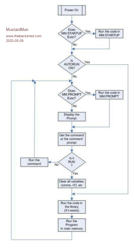

Perhaps it is the autorun getting there first... I know I saw a flowchart of what happens at turn-on / reset, but for the life of me I can't find it. The documentation is quite good, but it is horribly scattered and you need to peruse several manuals and collate all the tidbits from each.

The flowchart is on page 47 of the latest Micromite User Manual.

Finally found that flowchart...
Looks like the AUTORUN test is pretty early on.
