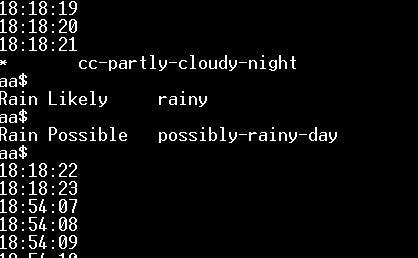

Does anyone know how to get this to store before sending it to the aa$?
At the moment it doesn't seem to be storing it before going to the sub decode
The last field is always a *
it seems to be printimg 3 times
DIM aa1$,b$,c%
on error skip
udp server 4997
do
on error skip
UDP receive aa$,b$,c%
if c%>0 then
  DECODE
end if
ss$=mid$(time$,7,2): IF ss$ <> sec1$ THEN: sec1$ = ss$: print time$ : ENDIF
loop
on error skip
udp close
SUB DECODE
a1$ = FIELD$(aa$,1)
a2$ = FIELD$(aa$,2)
a43$ = FIELD$(aa$,43)
a50$ = FIELD$(aa$,50)
print a1$, a10$, a43$, a50$
print "Fin"
END SUB
This is the output
Edited 2020-12-13 04:08 by lew247
Posted: 06:25pm 12 Dec 2020
Storing what where?
a10$ doesn't seem to be defined. OPTION EXPLICIT may help.
What do you expect to receive in aa$? Where are b$, c$ defined (sender ip and port)?
Edited 2020-12-13 04:34 by lizby

Joined: 23/12/2015
Posts: 1709
Posted: 07:00pm 12 Dec 2020
  lizby said  Storing what where?
I didn't have option explicit because it's just a "simple" test program to make sure another will work
It's receiving from an ESP32 and I'm sending it to this machines IP address
It's definitely getting the complete string that's sent because if I do print "aa$"
it shows me the complete string I've sent from the ESP
I did have an error which I've now corrected but it's still doing the same
going to SUB DECODE before the full string is received
I thought it would not go to SUB DECODE until the complete string was received
I put the "*" in field 50 so I can see it's decoding properly as the "*" will always be in that position
OPTION EXPLICIT
DIM ss$,sec1$,aa$,a1$,a2$,a43$,a50$,b$,c%, sec
udp server 4997
do
on error skip
if c%>0 then
  DECODE
end if
ss$=mid$(time$,7,2): IF ss$ <> sec1$ THEN: sec1$ = ss$: print time$ : ENDIF  ' So I can see it's running
loop
udp close
SUB DECODE
a1$ = FIELD$(aa$,1)
a2$ = FIELD$(aa$,2)
print a1$, a2$, a43$, a50$
print "aa$"
END SUB
This is what's printed

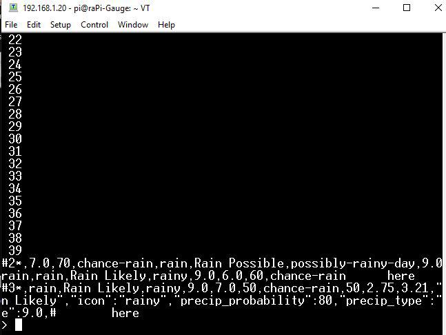

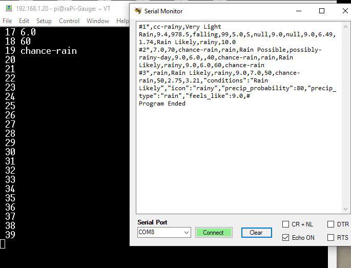

Posted: 09:48pm 12 Dec 2020
  lizby said  If each is less than 256 characters and there's enough time between them, why couldn't you LONGSTRING APPEND them?
I tried that but the manual says you have to use () for append and not $
I can set any delay between the UDP send because it comes from an ESP beside the MM
I guess I could connect them together using com ports direct or via HC-12 but I'd rather they were seperate which is why I'm hoping to get UDP cracked
Posted: 10:13pm 12 Dec 2020
"Couldy" would be correct if the third field was extracted from the string beginning with "*,cc-cloudy,Cloudy,6.3,993.0,rising,93,1.0,SW,null,1.0,null,5.0,1.74,1.59," (etc.)
But "8.0" is correct for the string beginning "Rain Possible,possibly-rainy-day,8.0,6.0,40,chance-rain,rain,Rain Likely,rainy,9" etc.
How do you determine which of the UDP strings you are working on when you try to extract the third field?
When you send the strings, can you tag them with something like "#1...", "#2, #3 and then do something like
tag$=mid$(aa$,1,2)
select case tag$
 case "#1": ' do field extract
 case "#2": ' do field extract
 case "#3": ' do field extract
end select
Edited 2020-12-13 08:18 by lizby
lew247
Joined: 23/12/2015
Posts: 1709
Posted: 11:16am 13 Dec 2020
Nope
I've tried literally everything I can think of
I've made the ESp32 send
*string1#
#string2#
so it's easy to identify the start and end of each string
but nothing works
If there was only one UDP string and it was shorter then it would be fine because I can get that working perfectly
There's no way to tell the received UDP string to do 2 different things, I've tried case select, field$, if/then but none of it works properly
I think I'm going to have to use serial instead
