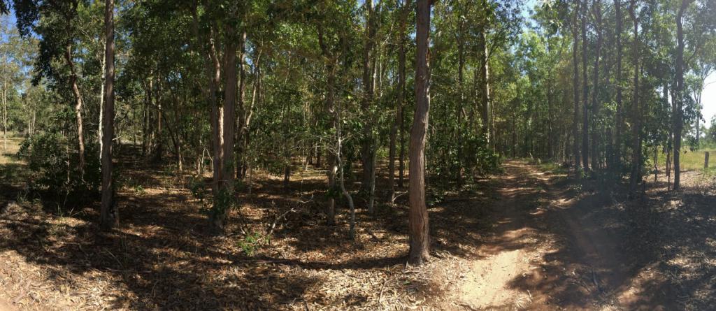

I have some sheds down the back I'd like to extend my network to. The block has a gentle slope up hill toward the sheds and through trees. Here is a photo:
I'd prefer not to trench and pull cable.
What's the best way to do do this wirelessly and cheaply? Does anybody have experience? It's approx 200m in total.
I tried a $30 eBay 2.4GHz Yagi antenna but it made absolutely no difference to range - it was the same as the supplied dipole antenna which got about half way there before losing signal. I'm using some D-Link routers with DD-WRT in bridge mode at the moment and locking them both to WiFi N which I understand has the best range of the various standards.

Sorry I cant offer a decent WIfFI solution, especially as it doesn’t look like you have line of site.

Cheapest decent wireless link would be something like a set of Ubiquiti Nanostations, but I really don't like your chances of punching a wifi signal through 200m of trees that thick.
Might get away with it if you cable a few meters either end and put the wireless link in that clear paddock?

I know you don't want to trench it all, but wireless is a long shot in 200m of trees without spending a kings ransom on kit -and it can be quite variable.
I would get a mate with a mole plough (or rent one) of some flavour, dig in some 8-pair (plenty of spare for other stuff... telephone, alarm etc...) armoured UTP about 100m from each end, run power in one of the trenches. Meet in the middle with an ethernet hub in a little IP54+ cabinet bolted to a tree. Try 4 pairs for a stretch to gigabit, if no good then 100mbit should work (and almost certainly 10)
Earth the armour (gives a bit of a shield), go down about a foot and right in the middle of the track so you remember where it all is. Should do a 200m run OK. Might get a bit of a voltage drop on the AC line so make sure the hub has a SMPSU.
's what I'd do... a day's work if you are lucky and don't hit snags.
lost faith in wireless+trees ages back... get it all working then it is rainy and windy and it all goes to pot.
