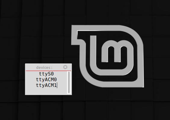

here's a handy little utility that linux should really have built in:
Serial Watcher (24-april-2020).zip
it is a 64-bit GUI program that creates a small window (about 150 pixels wide) on the desktop showing all the 'live' serial ports on the machine. these are serial ports that are real, working, with a device driver associated. as ports are plugged, they will be added to the window, as they are unplugged they will be removed.
it looks like this sitting on the empty desktop:
the executable is enormous (3mb) because of the lazarus GUI runtime engine. i shall ponder on how best to get around this in a future version. essentially, the only GUI component is a single TMemo sitting on an otherwise blank TForm. i feel it may well be possible to roll this in a more diy fashion for a considerably smaller executable!
please let me know how it works
rob   :-)

Posted: 02:11pm 24 Apr 2020
the inner workings are, in principal, surprisingly simple.
for each entry in /dev that is a serial port (ie ttyXXXn), there exists a corresponding entry in /sys/class/tty with further directories existing below that entry. the one of interest is of the form:
/sys/class/tty/NAME/device/driver
where NAME is the device name from /dev
for example, for /dev/ttyACM0 there exists /sys/class/tty/ttyACM0/device/driver
now /sys/class/tty/NAME/device/driver is a symlink to the actual driver, and we use a kernel (?) call to extract from /sys/class/tty/NAME/device/driver the true name of the device driver.
if the true name is NOT "serial8250", we can assume that the entry in /dev is alive, and our work is done. we can move on to the next entry.
however, if the device driver name is "serial8250", we then need to do a fileopen on the entry in /dev and call ioCtl to check that the driver type is not 0 (PORT_UNKNOWN).
in the case of my desktop machine, there exists on the motherboard a serial port, which appears as /dev/ttyS0. however, the driver is NOT called "serial8250", with the port implemented by an I2C device. so we can't assume that every /dev/ttyS* is an old-style 8250/16550 serial port!
on startup, the "watcher" scans /sys/class/tty/tty*, and for each entry found that meets the above criteria adds the NAME to the TMemo displayed. it then sets up a watch on /dev for any changes (items added or removed).
when a change occurs:
1. if the NAME is in the TMemo, it is removed.
2. the above check is done on NAME, and if it passes then NAME is added back into the TMemo.
hopefully this makes it all as clear as mud! i'd suggest having a look at the file "unit1.pas" that contains all the code that implements this. while looking intimidating, it is a series of quite simple steps.
