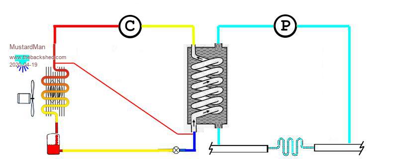

Can you provide some indications on what you wish to display? Preferably a picture or drawing?
panky
MustardMan
Joined: 30/08/2019
Posts: 175
Posted: 12:13pm 19 Apr 2020
This was something I cobbled up a few weeks back to get me started on the screen layout and where things would fit, in a around-about sort of manner. Several changes still to go. It is made up from snippets of a couple of HVAC schematics I scraped from the internet.
It is 800x320 pixels (the border does not show on a white background, and my drawing has a white background), and it is missing detail - there are several valves & sensors which have yet to be added. My employer is farming the real drawing out to a graphic artist to do a vector drawing which will be later rasterised for this particular controller screen. The vector drawing will also be used for other devices (eg: smart phone, web page interface, etc) to give the user a consistent feel no matter how they interact with it.
When interacting with it, the full page (800x320 pixels) changes to allow input parameters to be entered, and then reverts back.
Today I coded up a couple of functions/subroutines (in basic) that can save the image as a "RLE" sequence using PEEK (VAR array(), offset) and POKE. Very slow, but basis for conversion to a Cfunction. RLE works well as there are not many colours, and big areas of the same colour.
