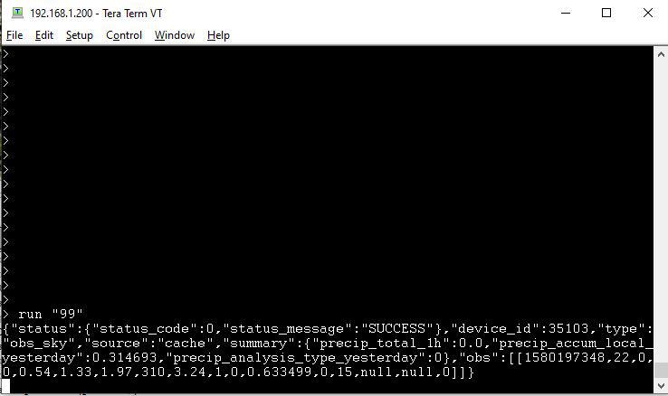

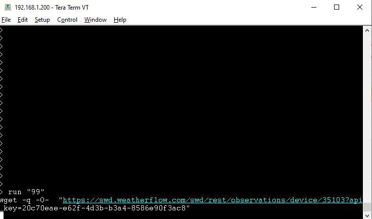

This is the section of code that calls the information
system "wget -q -O-  "+p$+"https://swd.weatherflow.com/swd/rest/observations/device/35103?api_key=20c70eae-e62f-4d3b-b3a4-8586e90f3ac8"+p$,e()
'longstring PRINT e()  ' print weather to test it works*
obs$=JSON$(e(),"obs")
print obs$
This is the result
If I uncomment out the longstring print e() and comment out the print obs$ I get this

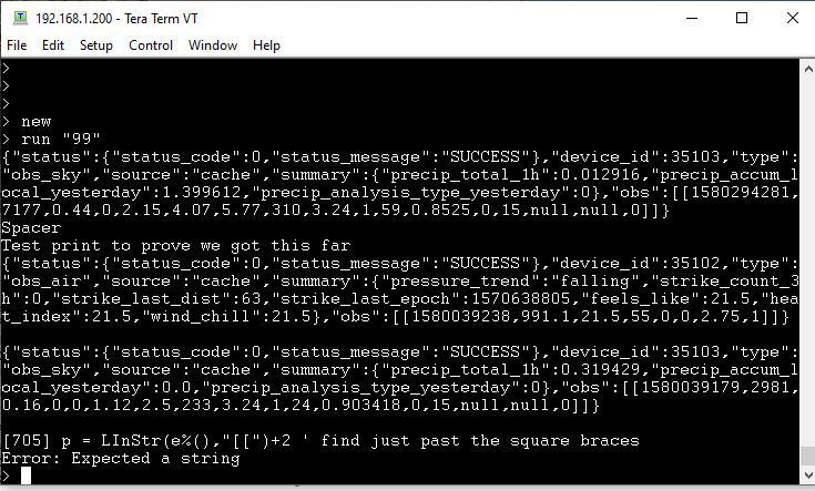

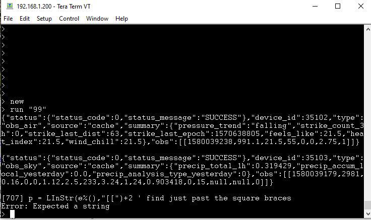

I can't use wget to fill the array so I did that by joining normal data.
lew247
Joined: 23/12/2015
Posts: 1709
Posted: 10:30am 29 Jan 2020
Getting a lot further
EDIT:
It's not reading the data received - it's only showing J1$ to k5$
I tested this by removing the get data line and it's showing the same results
This is the readings once I put the get data line in again and I told it to longprint e()
Edited 2020-01-29 20:40 by lew247

Posts: 6607
Posted: 08:06pm 29 Jan 2020
You mention
longprint e()
Is it e() or e%()
Based on your initial post, I used e%() but you may have to change it to e() in your code.
