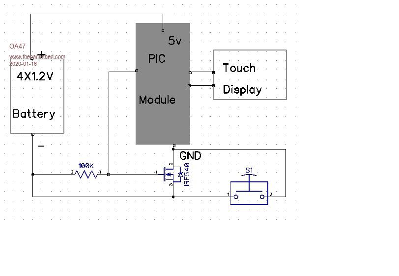

The needs of a Micromite program has led me to find a way to preserve battery drain on a handheld project. I wanted to be able turn on the unit easily and be able to turn it off by software (like a multimeter) after a pre determined time or when I have finished testing. I have devised a simple MOSFET circuit that will operate the Micromite and display when a momentary button is held in long enough for the Micromite software to push high an I/O pin to hold the mosfet on. Once the unit is running I used a Touch button to remove the output of the I/O pin or set a timer that will also turn off the unit if there is no input to the program for some duration. The circuit draws about 15uA when not in use which is quite acceptable for my needs but there maybe some tweaking that could reduce this further if needed.
Maybe someone might find the circuit handy.

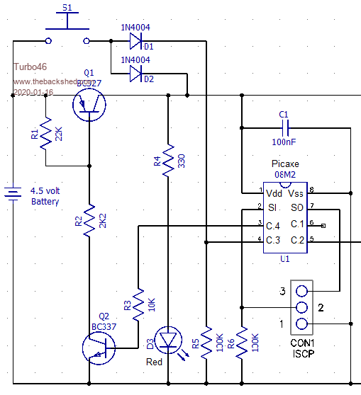

That could be useful, thanks. I came up with a similar circuit for a PICAXE:
This allows a subsequent push of the pushbutton to extent the timer. You could add a (blinking?) LED (or a beep) to indicate when the timer is nearly up as a prompt to push the button again. I have not kept up with FETs so I used transistors but I realise that a FET would be better. I could not measure any current drain when it was off.
Output C4 is raised as the first job of the micro and lowered at the end of the timer to turn the power off.

Dear OA47,
I am not sure how your circuit works. Does the PIC module contain a open drain P-FET ?
When the IRF540 is off, the source is at - level (say 0V), the drain switched off the PIC, so the PIC has 0V across it. This means that the drain of the FET is at +5V.
The PIC itself has Vdd=+5V, and since it is switched off, Vss=+5V.
How can the PIC output (IO pin) be at 0V level..? Due to internal diodes (inside the chip) the voltage at the IO pin can be between +5.6V and +4.4V, turning the FET on.
I have the idea that the PIC is snot switched off completely, it still has some 2V across it (Vdd=+5V, Vss=+3V). The IO pin is at 2.5V, and that is insufficient to turn of the FET hard. So it is leaking 15uA, insufficient for the PIC to start or run.
The circuit is a balance between FET choice and PIC choice.
Although this could work for you, I would not suggest this for all PIC's and different FET's.
Turbo's circuit does not exhibit this problem. Although, for a 08M2, it may not be necessary. There is a demonstration of a picaxe 08M2 that has been running in low power mode (without any surrounding circuit) for 11 years, blinking a LED, on AA cells. That seems low power enough.

very interesting subject. I have tinkered with this on and off over the years but it was always a solution looking for a problem, I never got to actually use it in anything.
My approach was similar to yours OA but I went for a PType in VCC - was afraid of parasitic leaks to GND through other components. seem to remember something like; the gate was held high though a resistor and the switch pulled it low, power then went to the uP which pulled the same line low - sort of like a latching relay circuit (which probably inspired it in the first place). Again, until a timer fired, the line went high and the thing turned itself off. It was a long time ago so I might be a bit hazy on the deets.

  Quote  Although this could work for you, I would not suggest this for all PIC's and different FET's.
In my situation I am using an Explore 64 module. I think I did put a 1K resistor from PIN 11 to the FET.
At the start of the program:
SetPin 11, DOUT
Pin(11)=1
To manually Power Down:
Sub PowerOff
I=MsgBox("Ready to power down","POWER OFF")
Pause 100
CLS
SetPin 11, OFF
End Sub
I do like to keep things as simple as possible. I had a quantity of these MOSFETs as I used them in a solar regulator circuit that was set up in a similar fashion except the circuit bridged the 10W panel when the limit voltage was achieved.

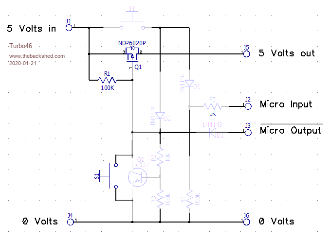

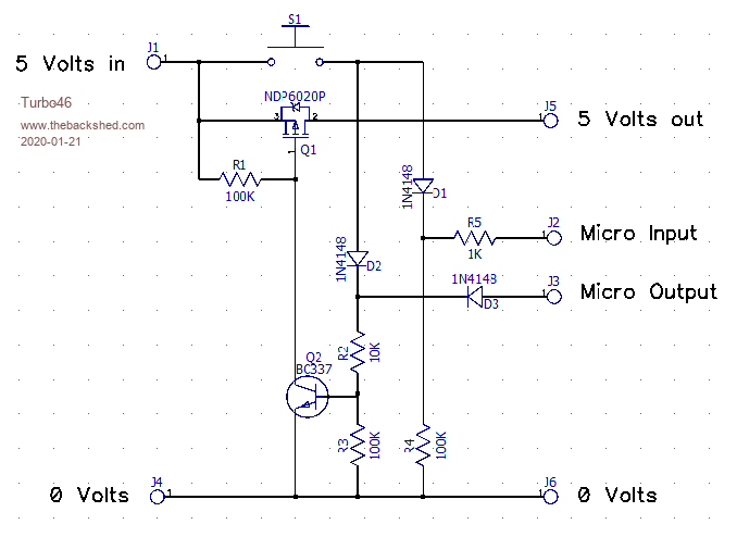

Here is my version of the circuit. My NDP6020Ps are still coming via snail mail so I haven't tried it yet. Bearing in mind CaptainBoing's comments above, a TO220 FET capable of passing 20 Amps may be overkill but it should be pretty robust. Also I left the gate resistor at 100K so if there is any suspicion that the circuit does not start up reliably this could be changed to 10K with no problems. Just a bit more current drawn while on. I just looked at that Youtube video and the resistor used there appears to be 4K7.
Pushing the switch will turn on Q2 via D2 and R2 which will ground the gate of Q1 and turn it on. The first thing the Micro should do is raise the output to logic '1' to hold Q2 on. Set it low to turn the power off. The Micro input can detect subsequent pushes of the switch via D1 and R5. The resistor from the base of Q2 to 0v is necessary to ensure the transistor is fully turned off when there is no input because the diodes D1 and D3 prevent the input signals connecting the base to ground.

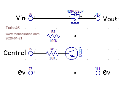

The circuit to control other devices is below.
The transistor could be any small signal NPN transistor you have available.
Posted: 03:01pm 21 Jan 2020
What is the function of R1?
Turbo46
Joined: 24/12/2017
Posts: 1694
Posted: 07:28pm 21 Jan 2020
R1 keeps the Vgs (Gate to Source voltage) below the Gate Threshold Voltage while Q2 is off. For a static (on or off) condition there is no current drawn, so  a high value is fine. Minimum gate threshold is -0.4 volts according the the datasheet.
During switching, the Gate to Source capacitance must be charged or discharged and current is drawn through R1 to do this.
With a lower value of R1 the Gate voltage will fall more quickly and so the FET will turn on more quickly giving a faster output voltage rise time.
We are only switching milliamps so the gate voltage does not have to fall very far to fully turn the FET on so I believe the rise time will be OK.
Please see CaptainBoing's comments above.
