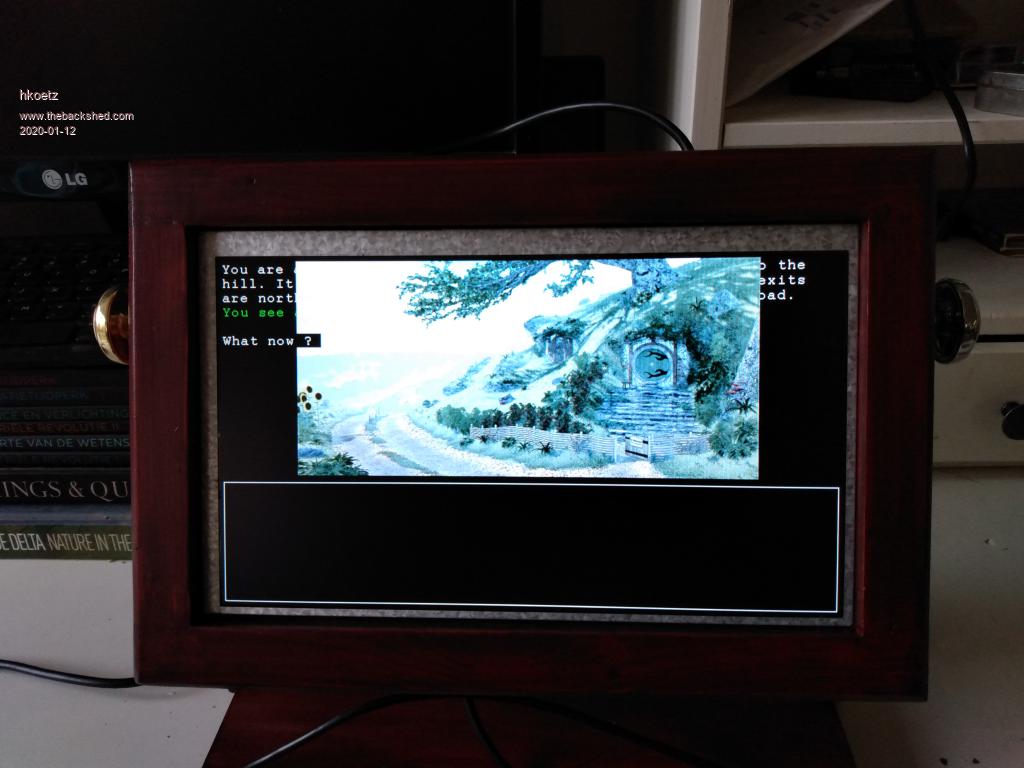

The attached photo shows what happens. How do I print and clear inside the box?

I get it. You paste a box filled with background colour over the text.
Thx
Posts: 11894
Posted: 03:42pm 11 Jan 2020
Not sure what you are trying to do. If you want to constrain the console to work inside the box it can't be done. In a program you just use normal drawing commands as per the MM2/MM+/MMX manuals
