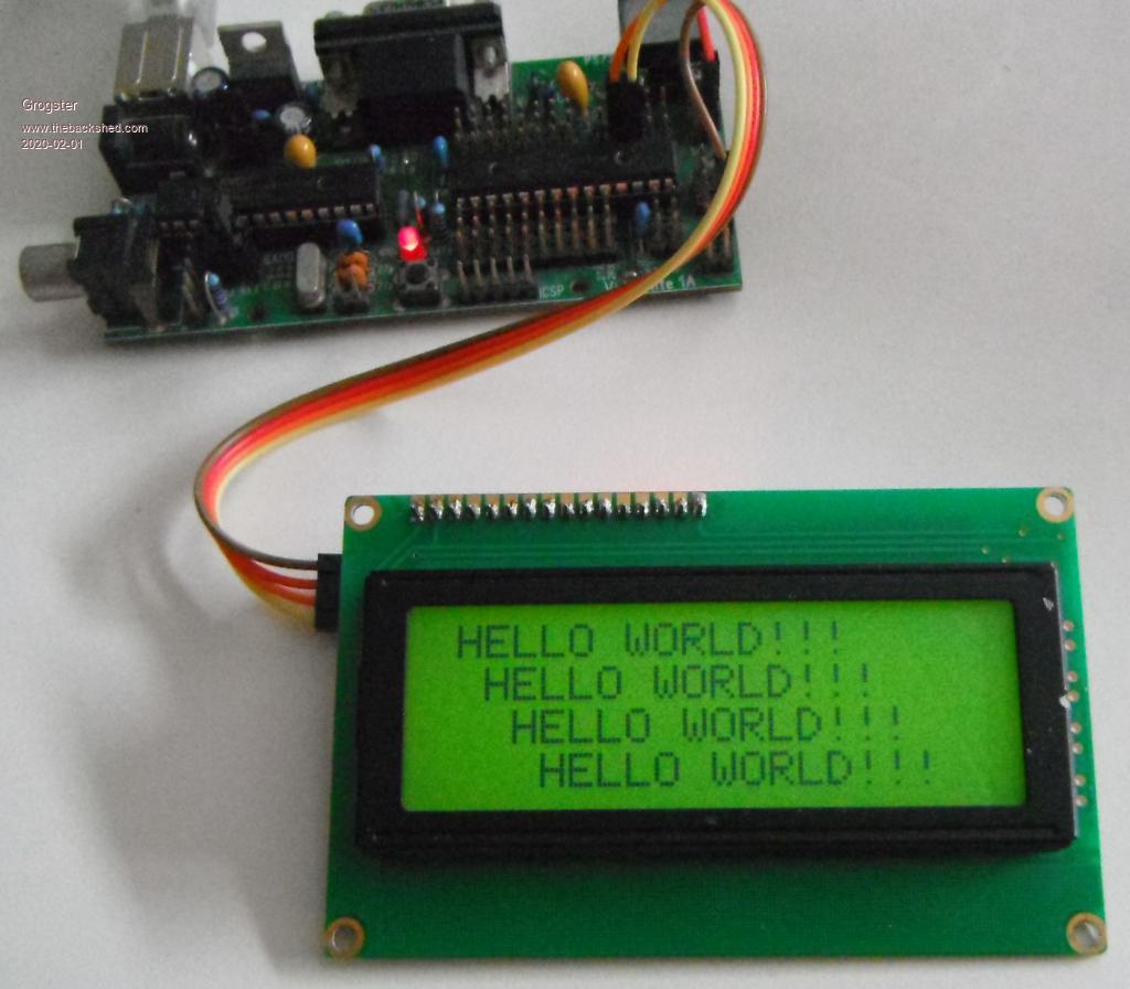

Posted: 05:04am 01 Feb 2020
My 8574 modules arrived the other day, so while I had a spare second this afternoon, I had a bit of a play with one using GTG's demo code - thanks very much for posting that, GTG, as I doubt I would have been able to work out the mathematics for the MSN/LSN nibble stuff for the commands to the LCD without your example code to study.
I did have the almost standard head-scratching when I got the slave address wrong, but once I fixed that, it sprang immediately to life.  My mistake was ASSUMING that leaving A0/A1/A2 open meant those bits were zero.  It is the other way around.  The comments in GTG's code mention that, but it took a few minutes before I managed to read that and realise my mistake.
This LCD is a TOPWAY LMB204BDC unit I had in my spares.
These seem to be a good quality and reliable LCD module.
Not cheap eBay rubbish, as they cost about $30 each.
Well, they did THEN, but these days.....
I also have some of those 20x4 LCD's from eBay too, which are white on blue.
I might just have to dig one of those out and play with it next.
I must say that even with the code delays enabled, the I2C method works well, and the LCD displays the text very quickly even though there is a lot of bit-conversions going on here!!!
